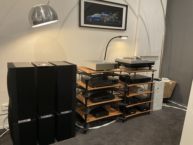

What a great looking system
Like your SL-1000R - first I’ve seen in a system on here. I had a bit of a look at one when buying my 1200G, they certainly look and feel very solid! Sadly I didn’t get a listen. I’m not going to ask how it compares to the 1200G X)

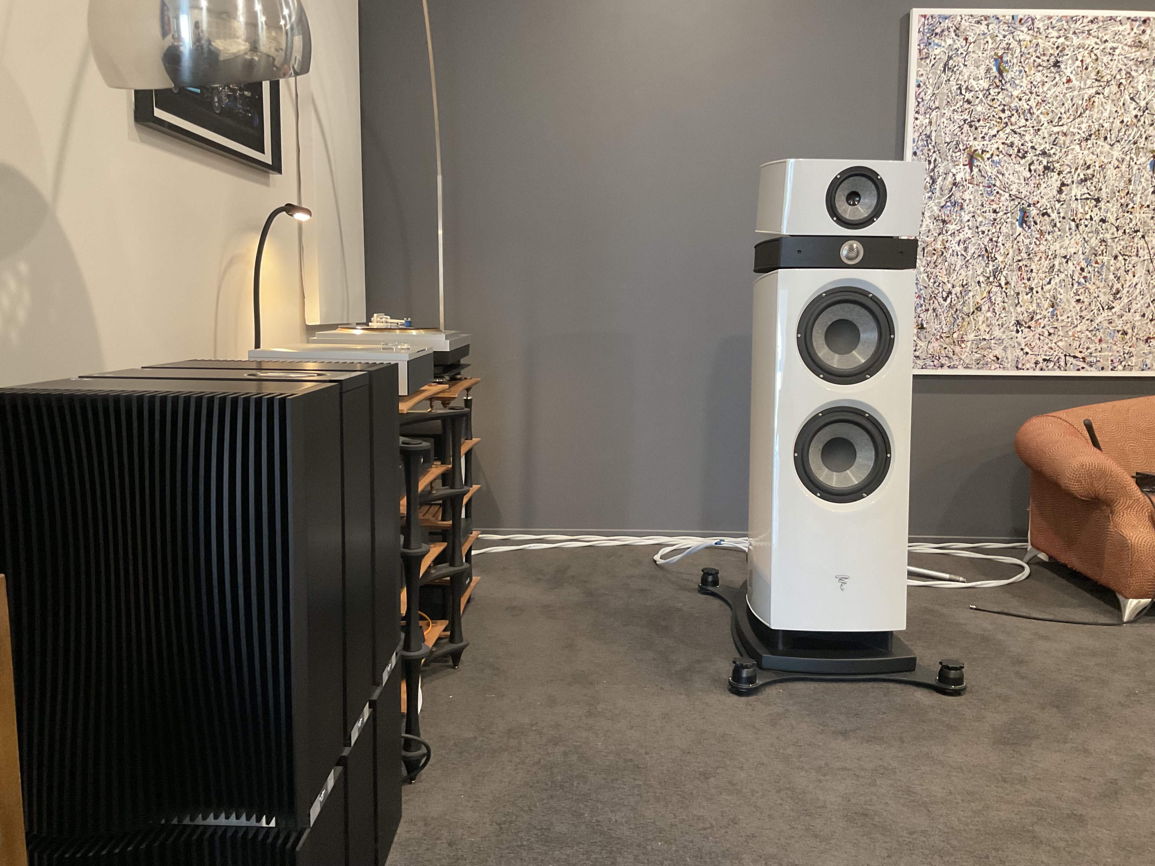

What speakers are you using?

The service interval is not the useful life expected. Our service interval is to keep the equipment in peak listening performance. Over time the large power supply capacitors (circled in red below - inside of the NAP S1) lose performance storing less energy and ability to release energy fast. This has an effect on sound quality.

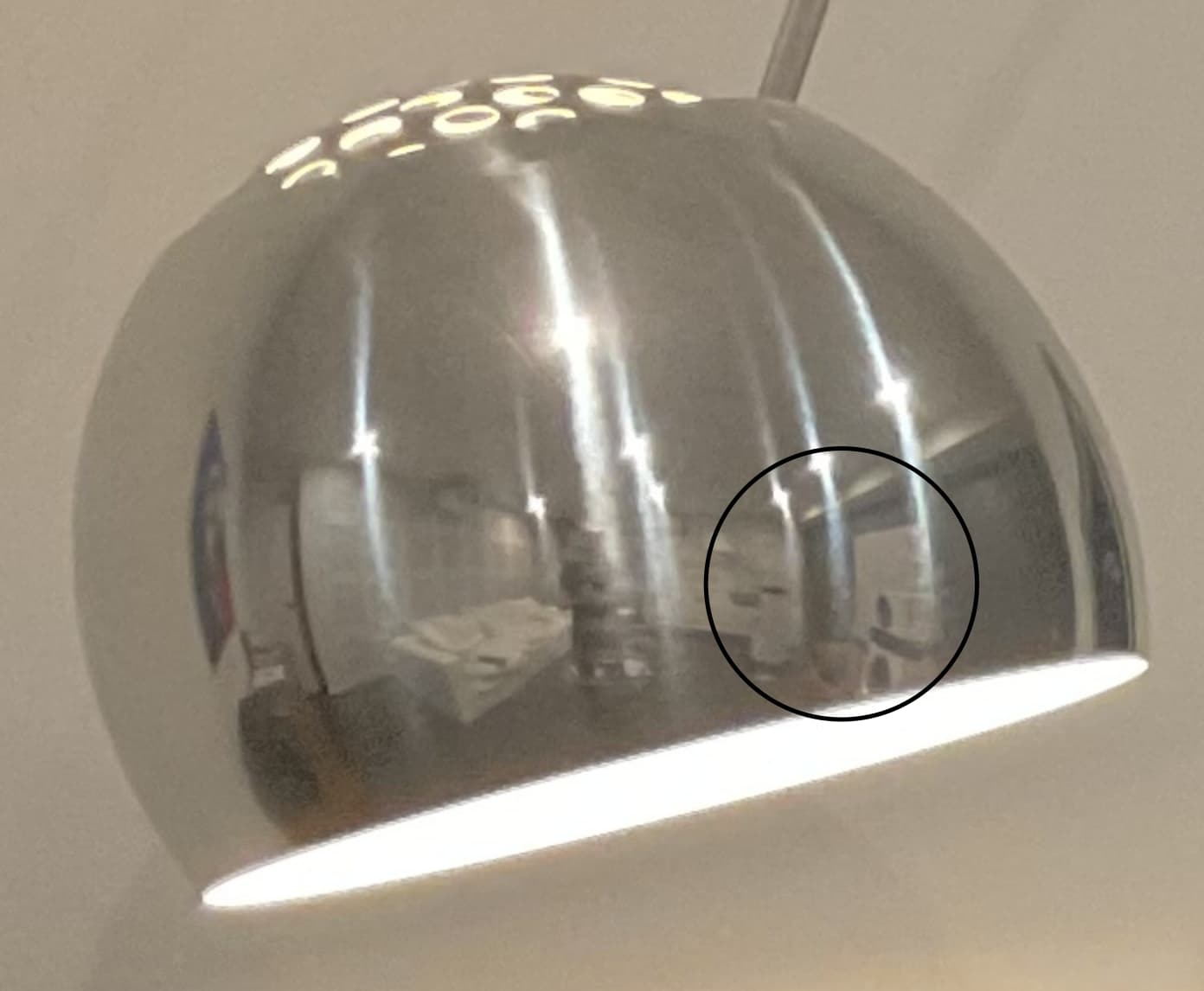

…Looks somewhat like Focal Scala Utopia’ in the lamp reflection? :slight_smile:

That’s great detective work :wink:
Haha Eagle eyes!
Thanks very much for the info Steve. Somewhat comforting given the logistics involved when they do need to come back to you. And when a servicing plan is worked out an idea of the cost would be helpfui. And yes quite the detective close but no cigar. They are Maestro Evos. They do work very well with the Statements. I had 800s previously
