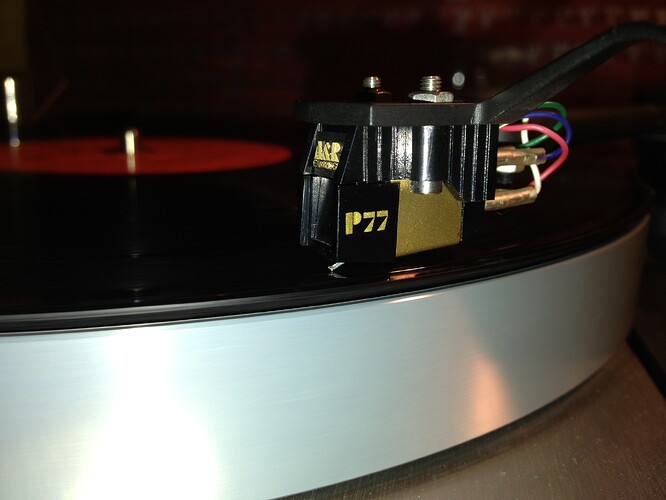

Thank you Tony, yes the P77 is just like your pic
It may be possible that if the P77 stylus is original 1978ish, that the suspension has perished or hardened. So, if you get it set up and it sounds worse, it may not be the turntable. A replacement stylus by Jico is advertised at £209, so an expensive trial. I think the E77 stylus will fit, at £36 a bit more affordable.
