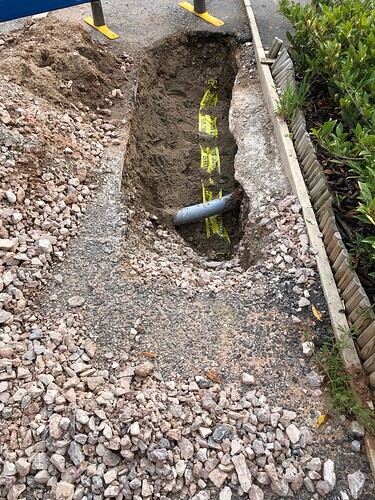

Actually I think there is something in this. I’ve just dug up the road to shield my Mains cable, and the difference is amazing - so much airier when the ants cant get to it :blush:
