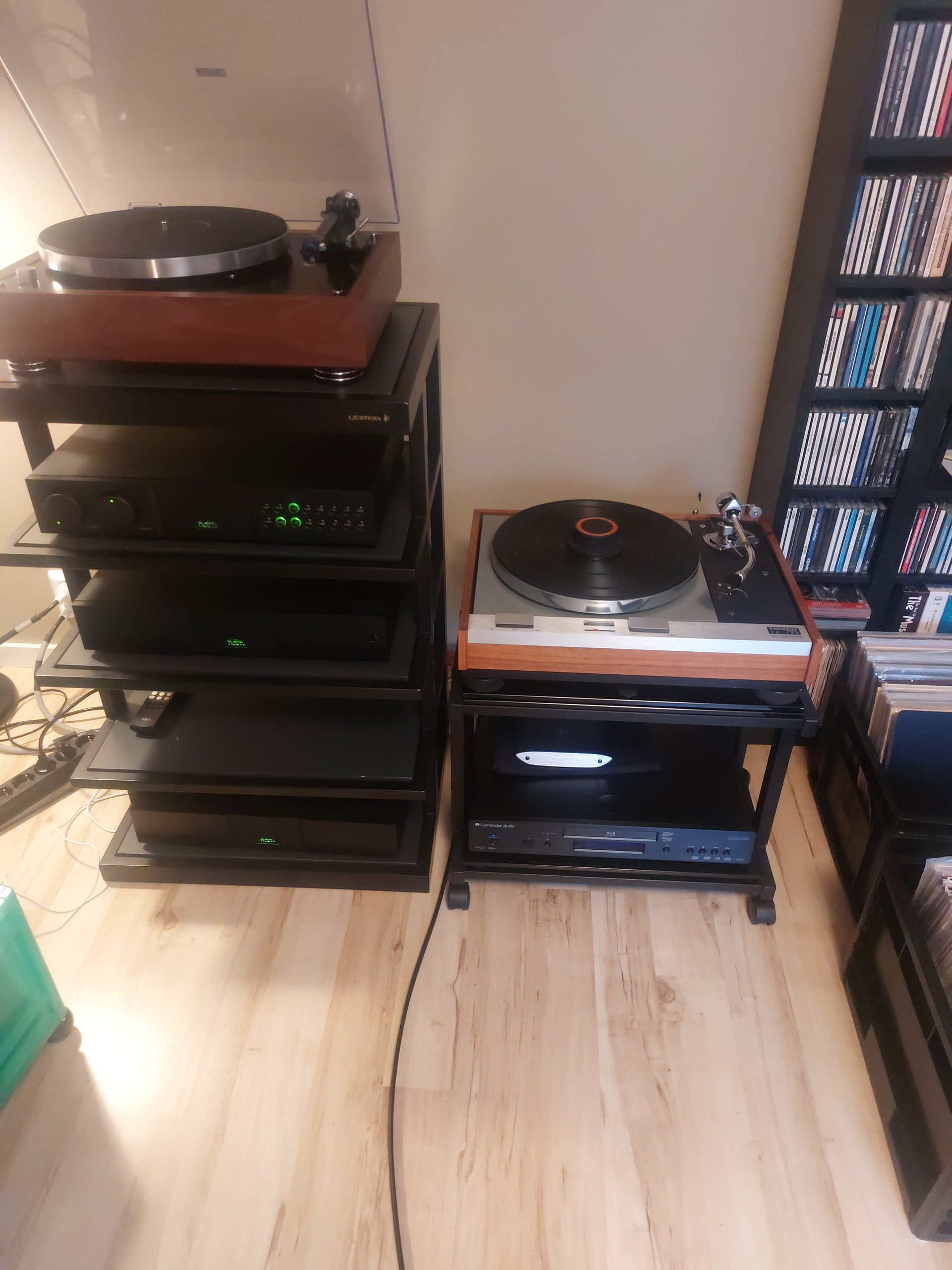

My custom-built Thorens TD160B MKII and the newly refurbished Thorens TD125 MKI which will soon be playing together with the Cyrus Phono Signature and Cyrus PSX R MKII. Exciting.

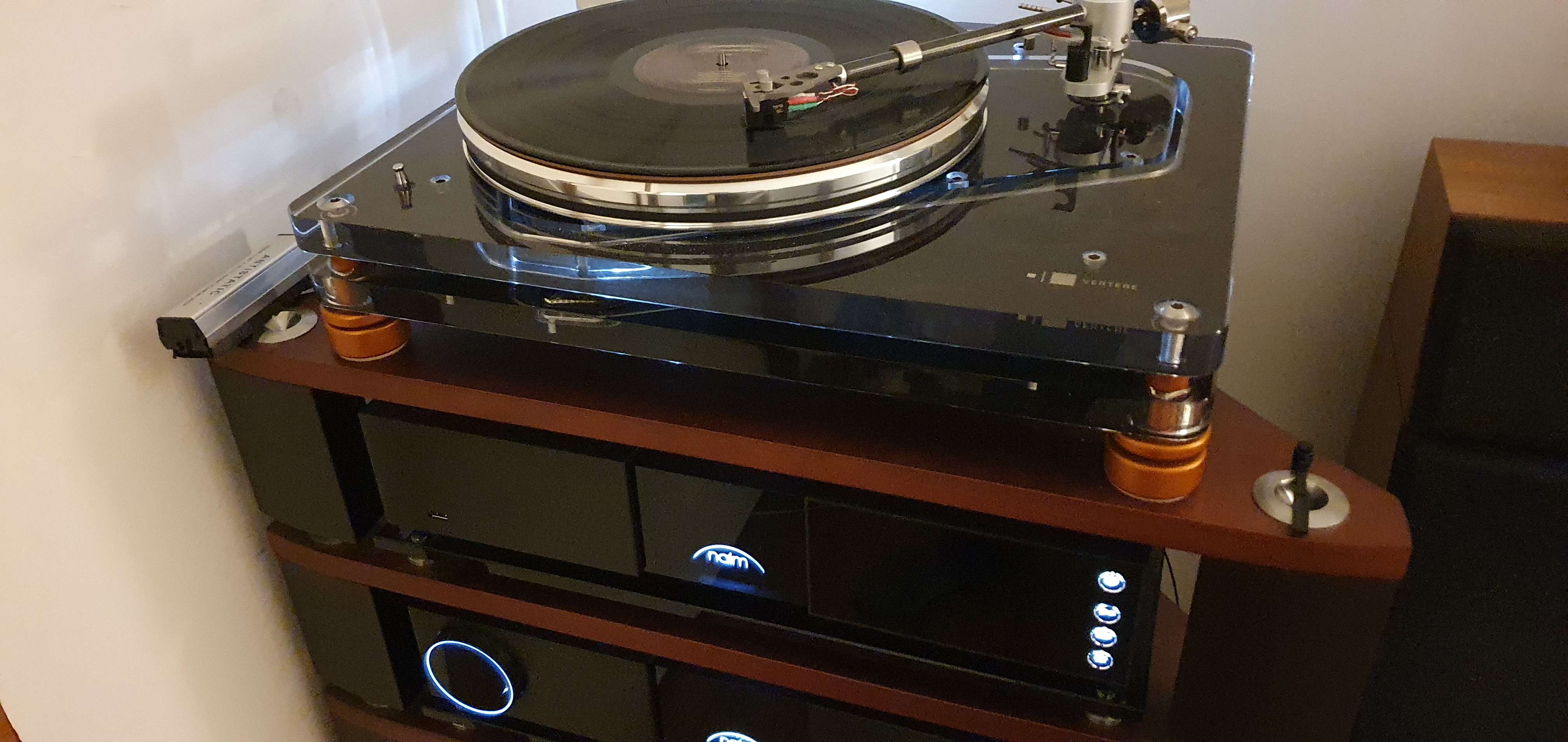

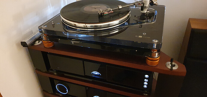

This P8 is incredible… besides being beautiful (in my opinion!), it’s musical… in fact, having still owned the P6, it’s a P6+++, still that beautiful coherence, that fluidity, much more dynamic but with better timbre, more detail without any harshness, it’s superb to listen to! My Moon 180 streamer is far behind…
@registlse
A superbly elegant looking TT. Far prefer this to some ot the metal monstrosities.

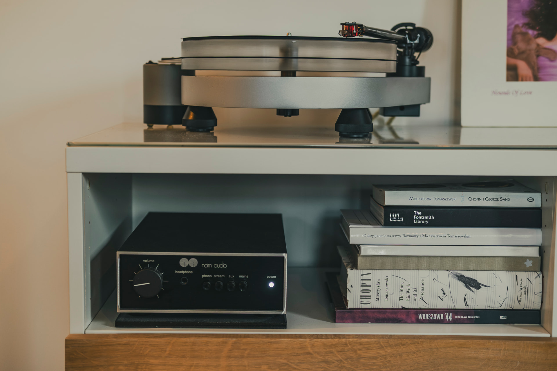

I’ve made a few posts recently bigging up my new wonderful nss333.. but “Rattle that Lock”, Dave Gilmour on vinyl on my MG-1, well… the 332 really sings, next level, out of this world!

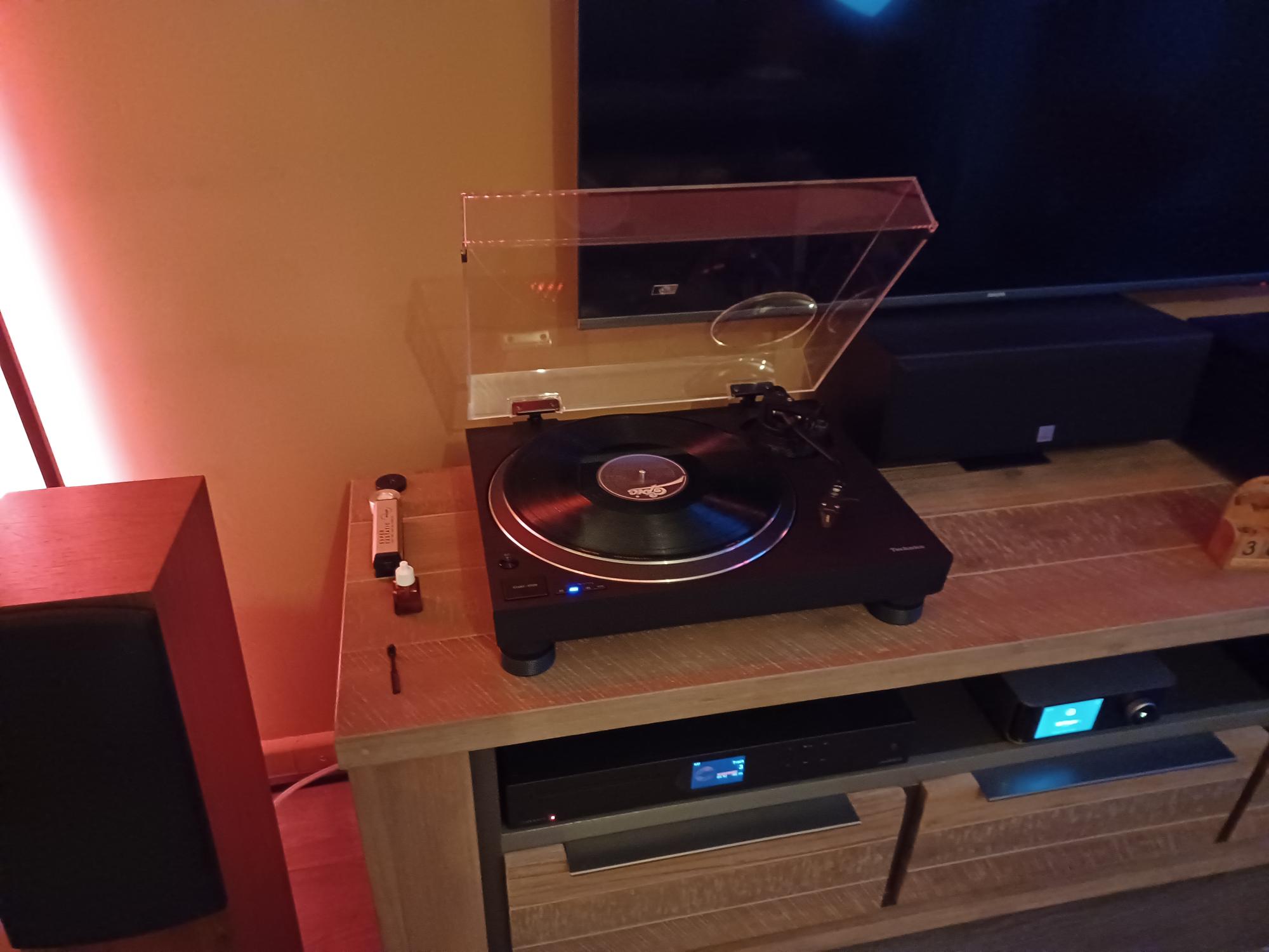

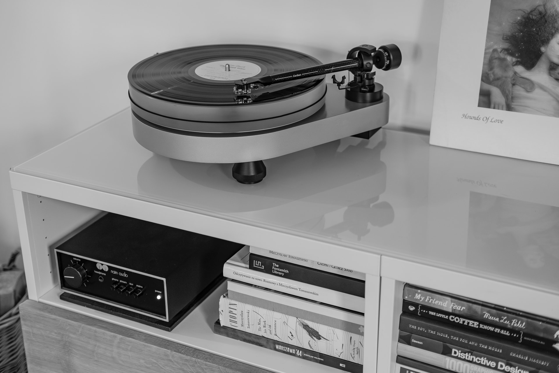

Picked up this used ProJect RPM 9 from a friend, paired with a new Denon DL-110 cartridge, to scratch the Vinyl itch.
Enjoying it very much so far.
