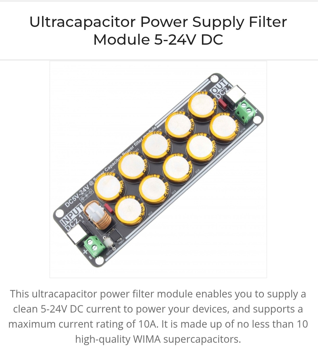

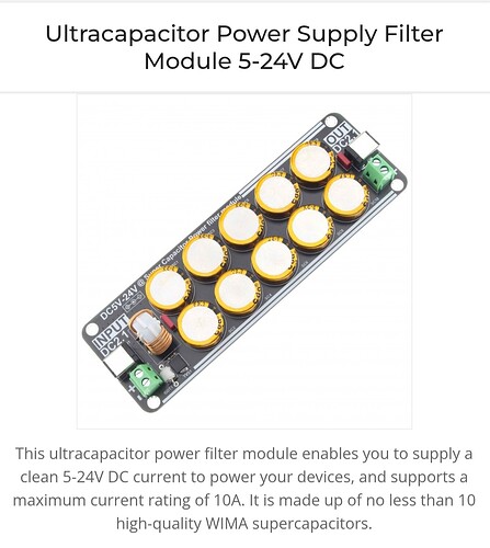

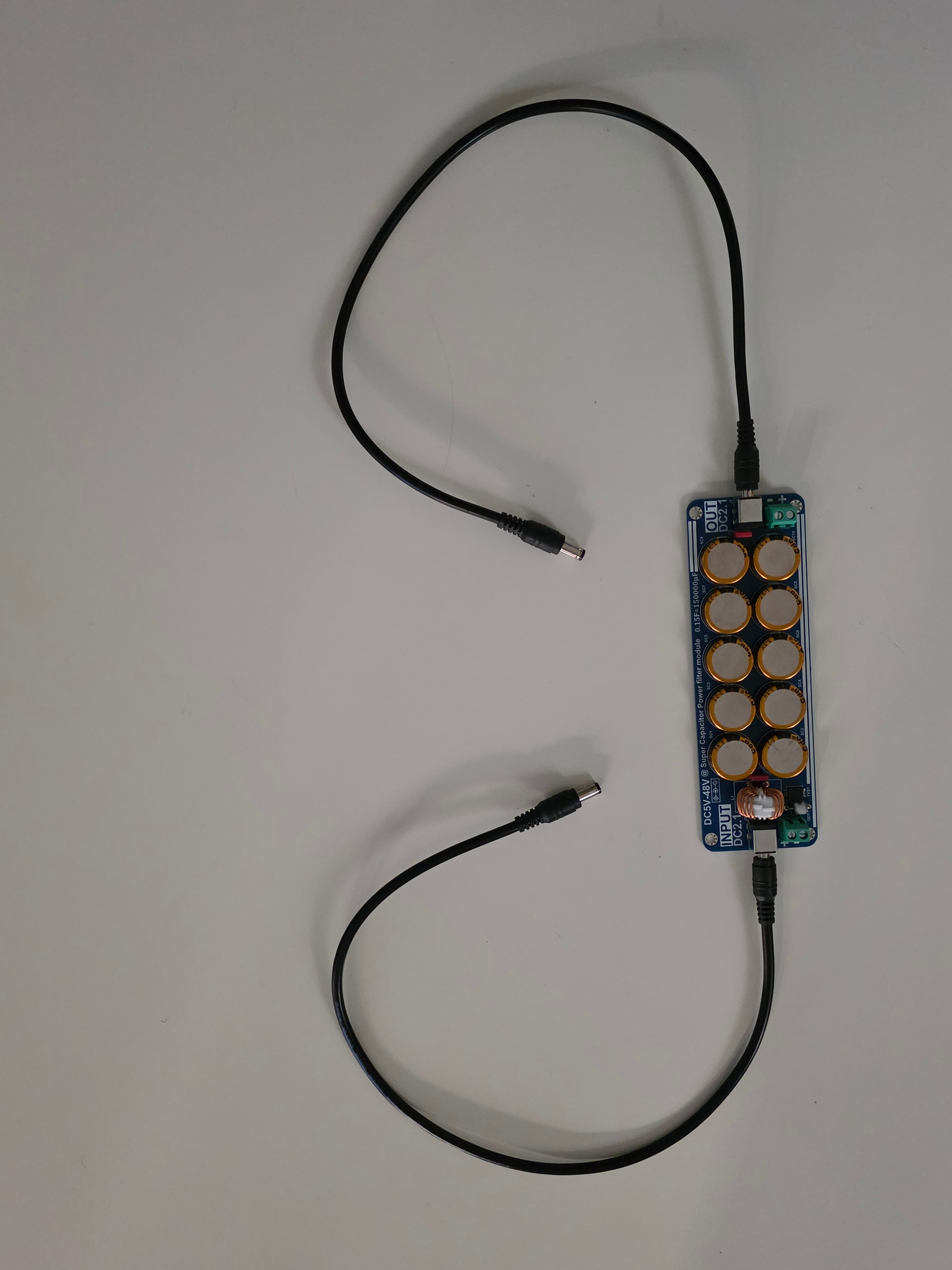

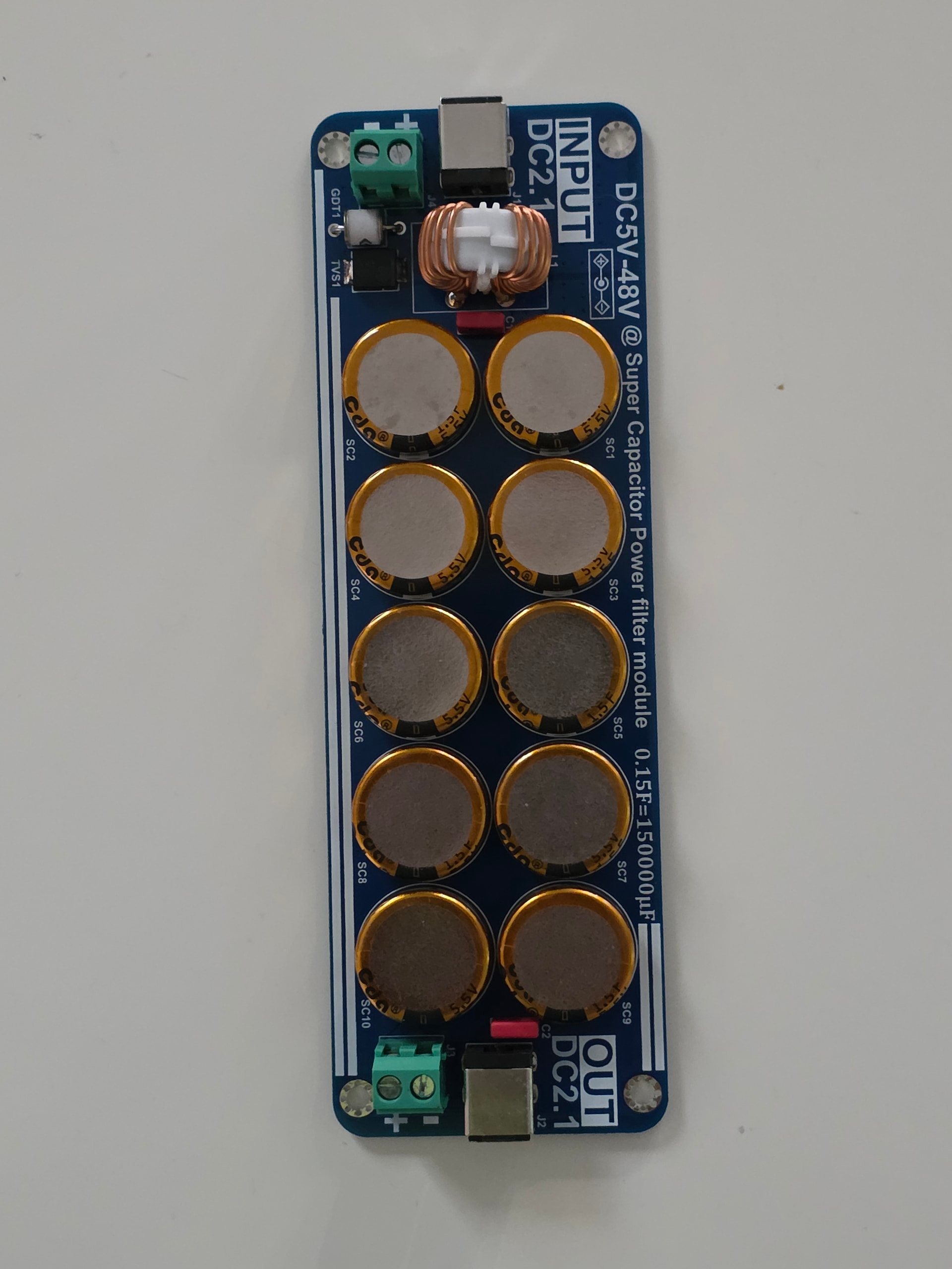

Can you explain how these DIY upgrades work / how to install it? Are they attached externally?

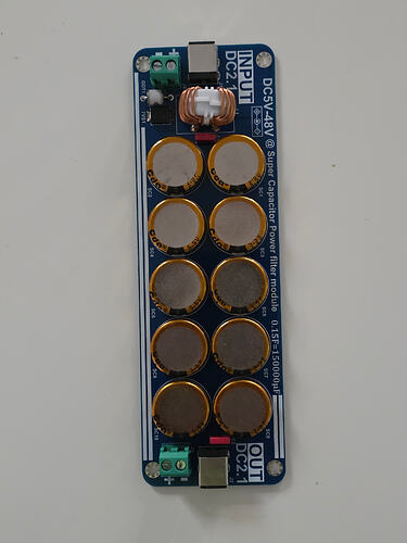

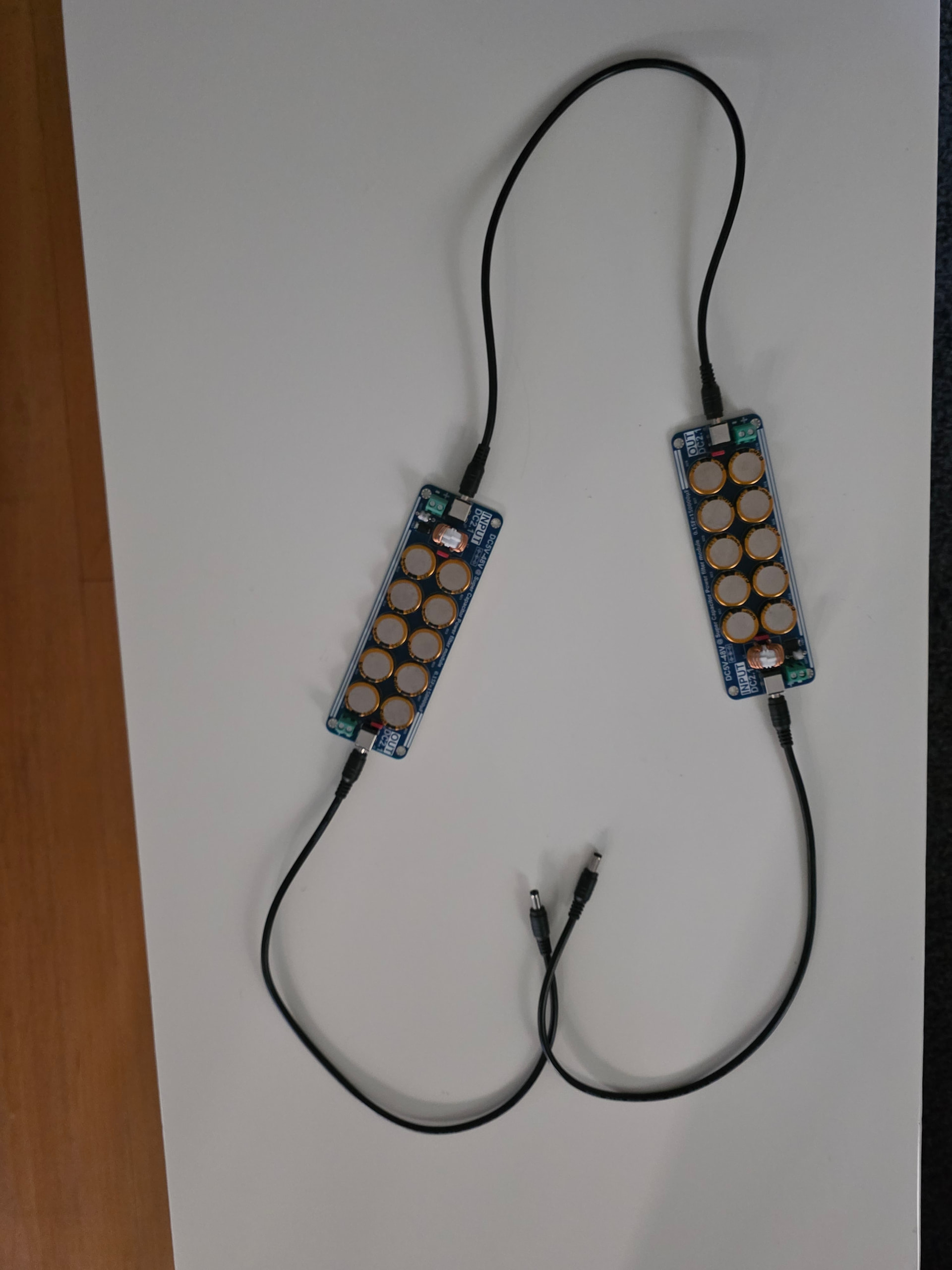

The supercap filter modules have input and output DC jacks. They just get plugged into DC cables.

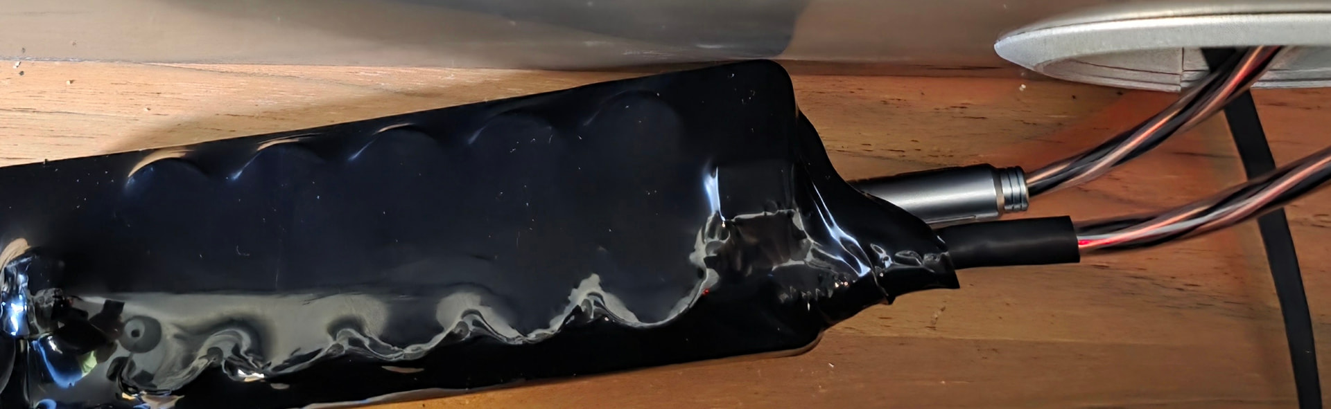

You can also daisy chain two. See pics. Then you need shrink foil to protect the circuit board. In the picture, i used black shrink foil.

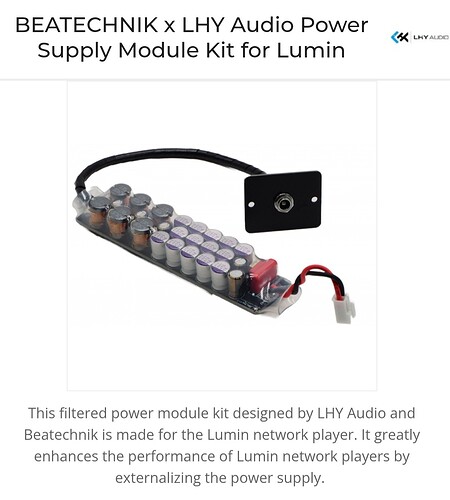

The LHY module for Lumin is a bit more tricky. Ot has a dc jack input but on the output you have to remove the Lumin cable and solder a DC jack or directly into the device. And the lumin module is for 12v input and output only. I use two of them for my switches, which both work on 12v.

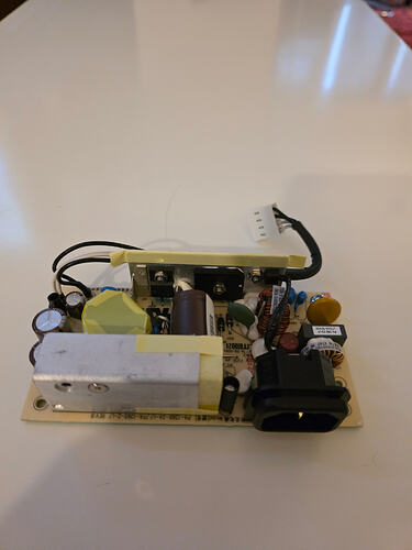

kWhat does the SCPS do? It looks like it’s powering a Cisco switch. Is this different to the linked filter modules? Just trying to understand what they do and what they supply. Cheers.
To use a DC SpSC on the Cisco, you remove the inbuilt AC powersupply (see pic). Very easy to do.
Where the 12 V DC cables of the inbuilt powersupply go in the Cisco, you solder a DC cable with a 2.5mm DC jack. This way you can use any 12V DC supply on the Cisco.
The filter modules can go in-between the DC powersupply and the new DC jack in the Cisco.
If your Farad has 12v output, using it for the Cisco will likely have a very good effect
