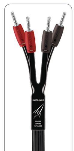

I thought the OP’s “a speaker wire w 4 plugs at speaker end” was about single cables with bi-wire ends like this from Audioquest (“Single Bi-Wire (SBW)” in their parlance for the Rocket series):
= Y end (Edit: assuming the cable splits at the end shown, not the other end)
It equally could mean the wire going to and out of plug, then to the second.
However @Mike-B is right, and althou the OP didn’t say bi-wire it could be read as that, with the amp end having a pair of wires attached to each plug, which may not be beneficial and may have negative impact.
Right, and in the AQ Rocket case it’s actually two wires in one cable and AQ writes somewhere IIRC that this termination reduces inductance, so Mike-B’s correct answer seems to apply here as well
Yes, AQ splurge on this says “Double Low-Inductance Geometry: A “normal” speaker cable has fairly high-inductance, smearing energy across time and making the sound dull and unfocused. The two conductors in each half of Rocket 11 provide lower inductance, greater clarity and superior bass-to-treble frequency extension.”
