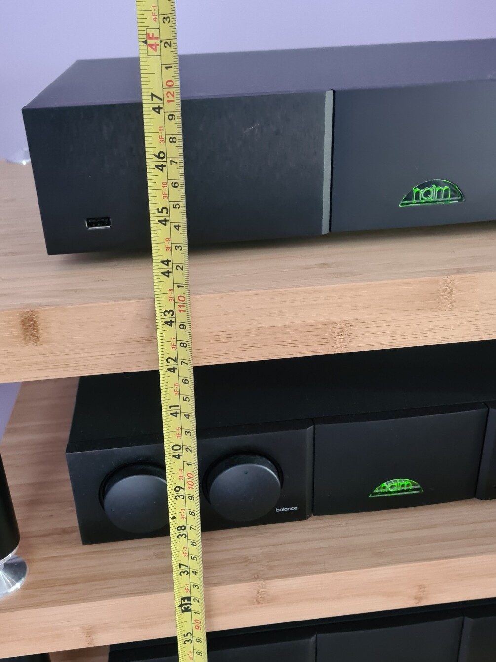

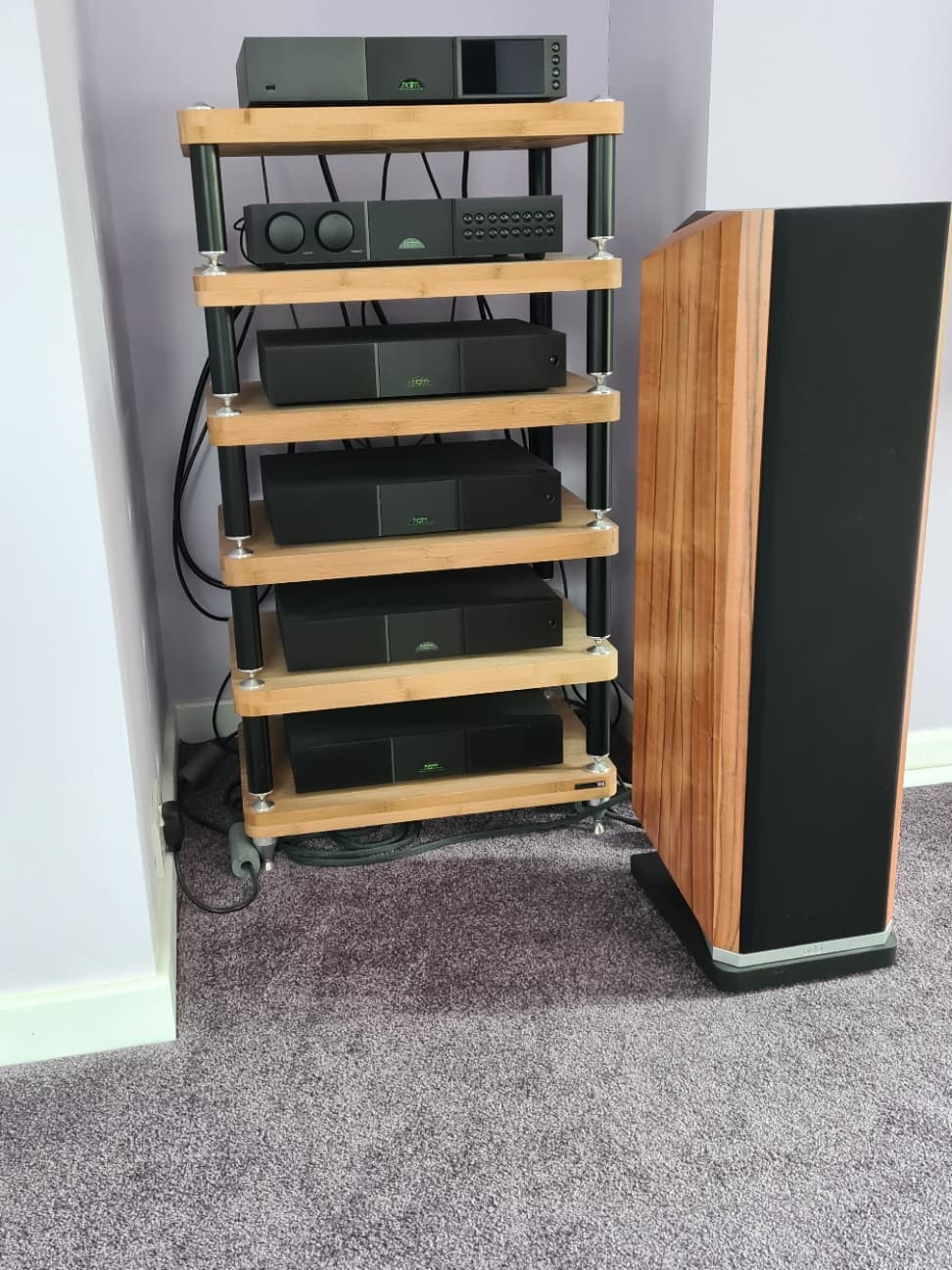

This is my system @Bisleyboy on Atacama Evoque 60/40 SE
As you’ll see the top shelf is 110cm 43" off the ground so no issues with height
The Naim kit fits just fine but I did have to purchase the smallest height legs 160mm - the rack kits tend to have the longer leg lengths
My stacking order which I appreciate is not the best is from top to bottom NDX2, 252, 300PS, Supercap, 555PS, 300

Correct. I suspect you have to order direct from Atacama to get all the short leg shelves and yes there’s plenty of space for air circulation. In my personal opinion the se2 rack would be a good choice
I know my order is wrong but I had to keep the 300 on the bottom for the Phantom speakers cables to reach. Other than purely based on trying to allow the Burndys to run free so to speak
