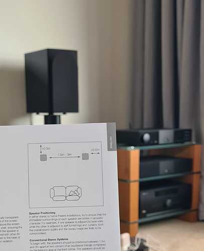

I’ve always had relatively small living rooms where my HiFi is. I usually follow the typical advice on speaker placement, not having near walls etc. and this is also recommended in any manual I’ve seen come with speakers. This evening however I put my speakers about 3" from the rear wall and it sounds like there is actually way less resonance with the room*.

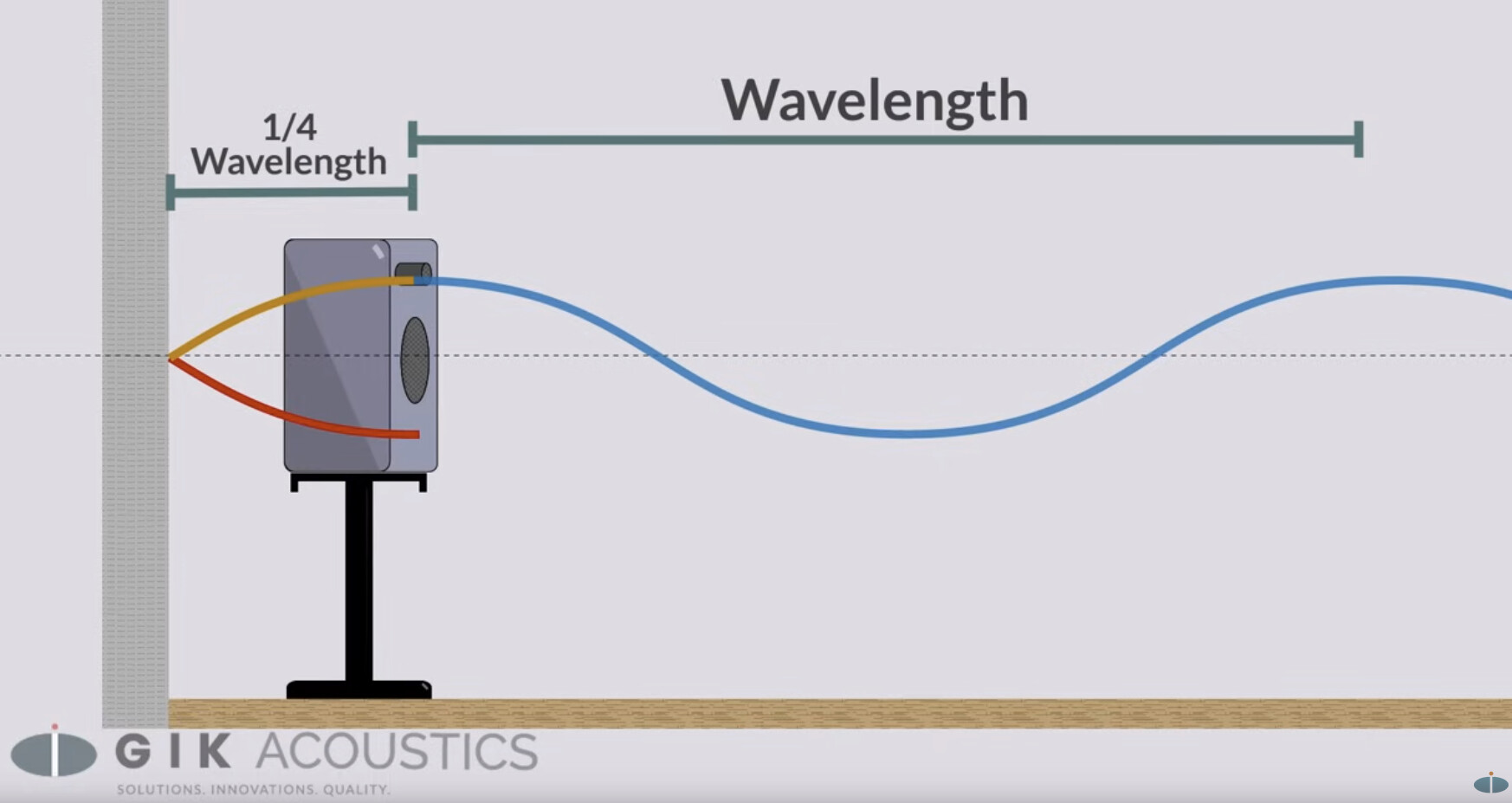

Interestingly GIK acoustics also advise trying speakers close to the rear wall in smaller rooms:

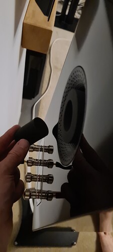

Thank you for the responses. After some further experimentation and lots of placing bits of tape on the floor to mark out positions the ‘rule of thirds’ setup I thought sounded best for me plus using part of the bung set that came with the speakers when the bass started sounding muddy:
