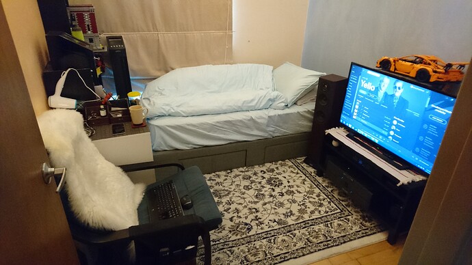

I have a setup in a small room and it sounds amazing. I would advice when you’re getting the speakers for your listening room is to really audition it in an environment similar to your room.
I have a similar sized room and have got it sounding OK using acoustics treatments by GIK (specifically some emphasised bass issues). Paul Rigby’s website gives some ideas for doing similar on the cheap. Sound staging will never be massive but no reason why a system shouldn’t sound good. Isoacoustics Gaia feet below the speakers also helped.
