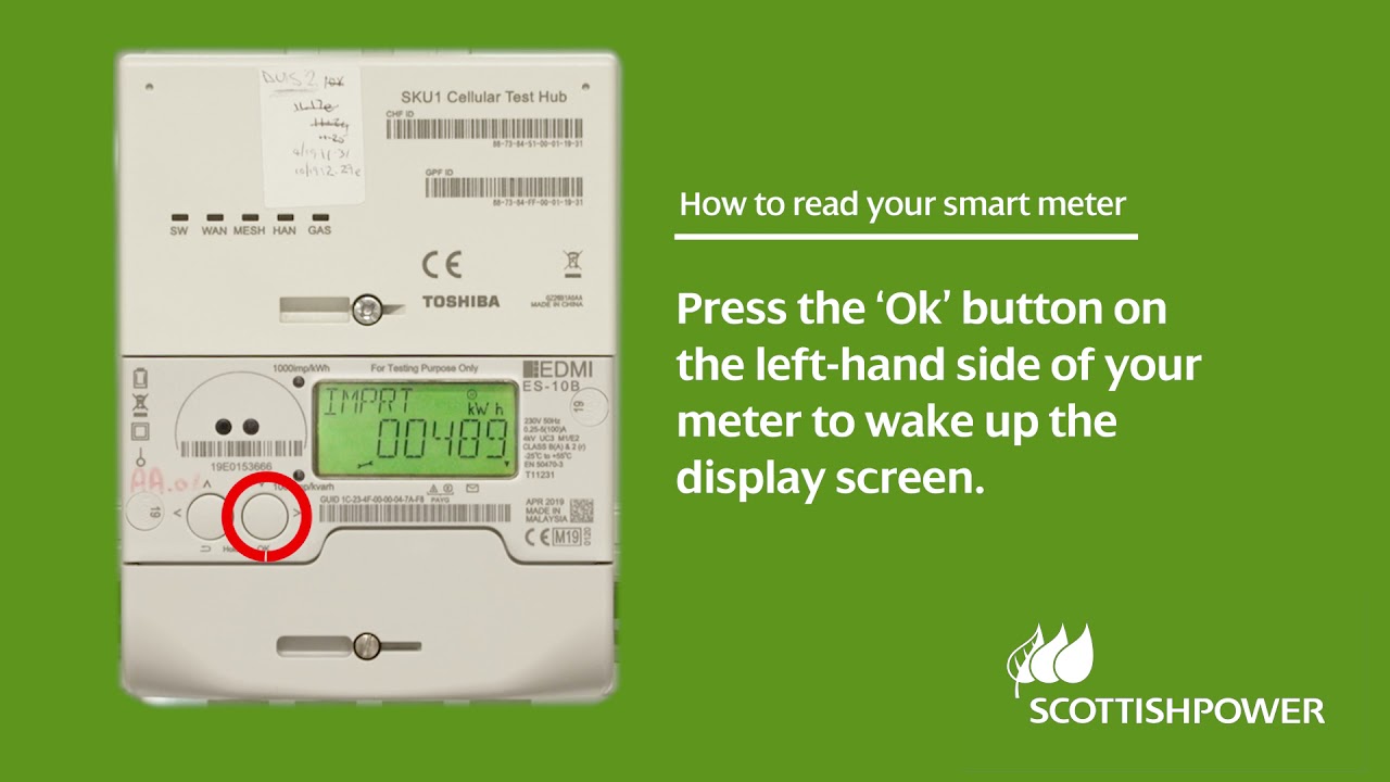

I’m surprised that you cannot get a reading from your meter. Any chance of a photo? You can usually press 9 for meter reading.

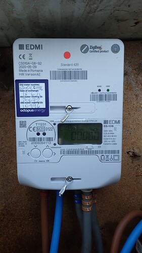

The meter has no option for displaying the reading on the device-this was confirmed when the latest meter fitter came last month. Photo to follow shortly.

This is the beastie. I tried the little home display, it would not link.
Bruce
I guess those buttons at the bottom do something - just seeing if I can find a manual…

Octopus talked me through the buttons on the meter but we agreed the display is not giving any useful information, not least as we also have an Economy 7 supply on this consumer unit and it is only showing one value not two. They could not explain this.
