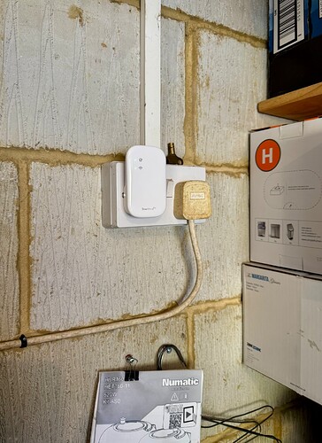

Our electricity and gas meters are at opposite sides of the house and so connectivity between the gas meter and the communications hub, located in the electricity meter cabinet, has always been a bit flaky. Same with our in-home display where signal strength was marginal when located at our preferred hallway table position.
As well as irregular gas readings on the in-home display, I was having to send in manual gas meter readings to our supplier. Not a big issue in the grand scheme of things but annoying when things don’t work as they should…

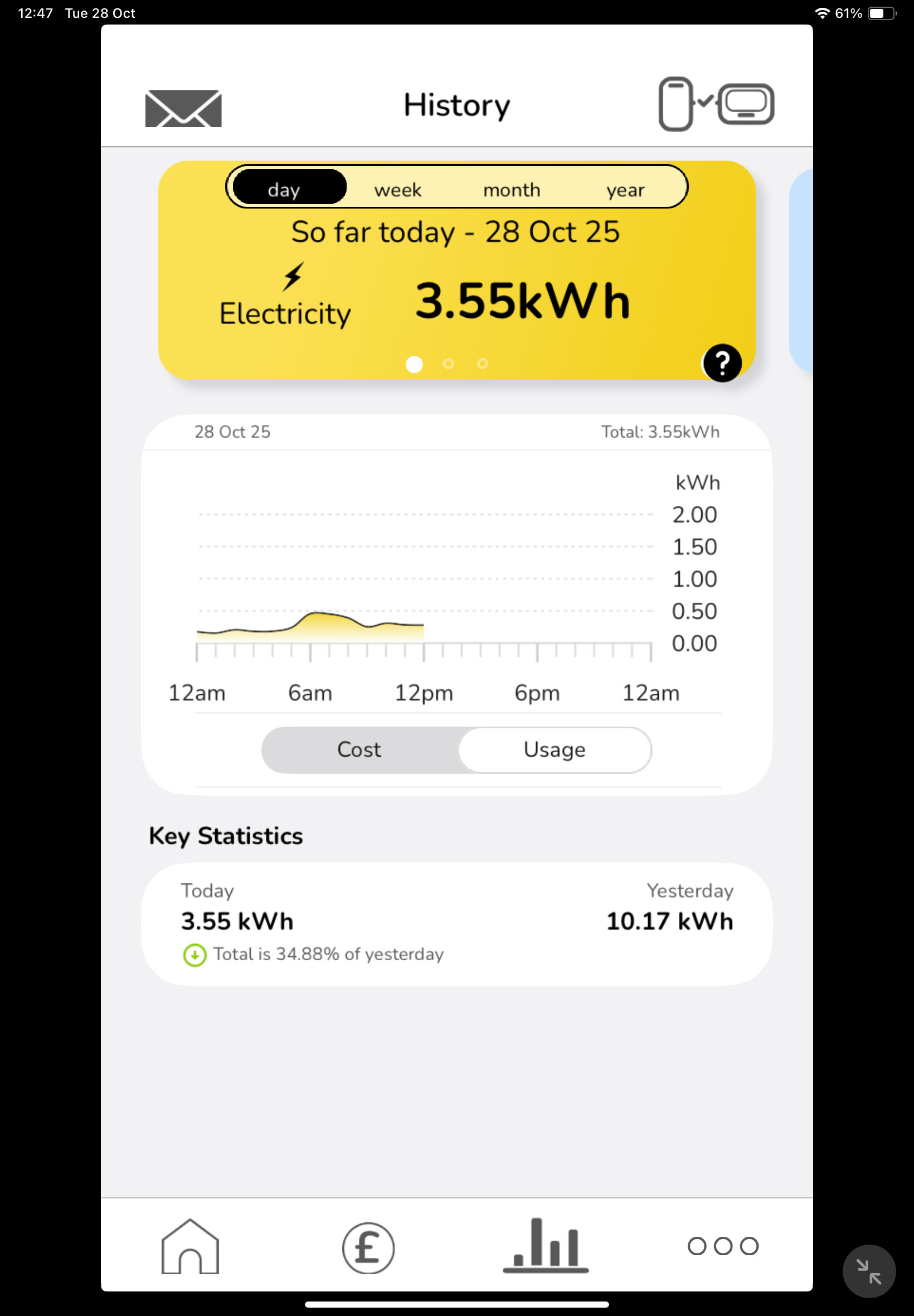

Googling around for a solution, I came across SmartXtend which is designed to extend the range of any Zigbee Smart Meter HAN. It looked like it could be a solution to our issues, extending the signal between the gas meter and communications hub and also improving the signal strength at our IHD location. I ordered the Pro version which adds Consumer Access Device functionality so I can use the Fuuli app to monitor our energy consumption.
It was easy to setup and install as it just plugs into a standard mains socket. I found a spot in the garage which was near mid way between meters. It’s been in place for a couple of weeks now and does what it says on the tin. We now get regular gas readings, both to the IHD and through to our energy provider. Problem solved.
We’re with Octopus and they gave us a little device that connects to both the house WiFi and smart meter WiFi. It allows us to see consumption on our Octopus phone app.
Presumably you mean the little pink box they give you that’s an alternative to a regular IHD, and gives you current usage figure in the app in addition to the historical usage info that you get anyway?
Hm, that looks interesting. My meters are next to each other, but the IHD does often loose connection. Also getting the data in an app would be pretty good especially if it includes energy exported from Solar panels - perhaps I’ll contact them.

Yes a dedicated Zigbee repeater will work fine, although many other Zigbee devices will relay signals anyway as they are designed to work this way, as in they form a mesh network.. such as mains powered automation devices.. but not all do this particularly battery devices.
