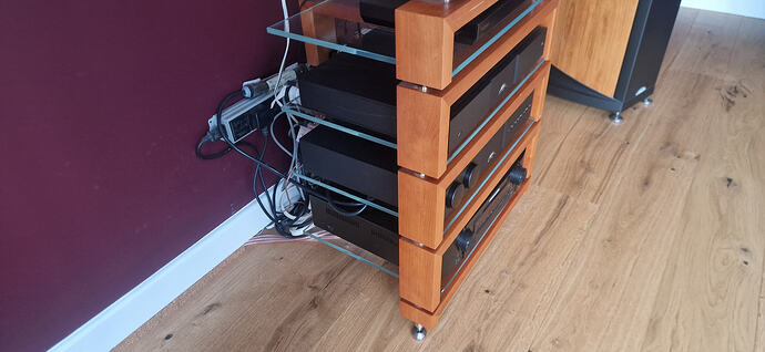

if the volume knob is at 12 o’clock that’s pretty high - does the Supernait have enough air around the case (the casework is the heatsink) for it to dissipate heat?

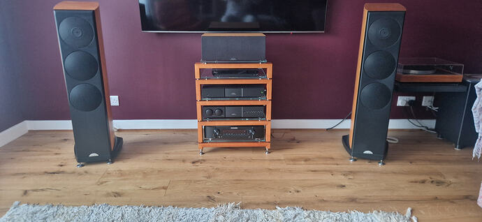

Typically I run it at 25% - 9 o’clock - but as it had just come back from the factory and I was on my own I thought I’d have a listening evening. It sits in a Simrak which is pretty open as you can see.
I agree that it was overheating, but I might have thought that running it at 50% should be OK for a couple of hours or so?
