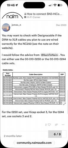

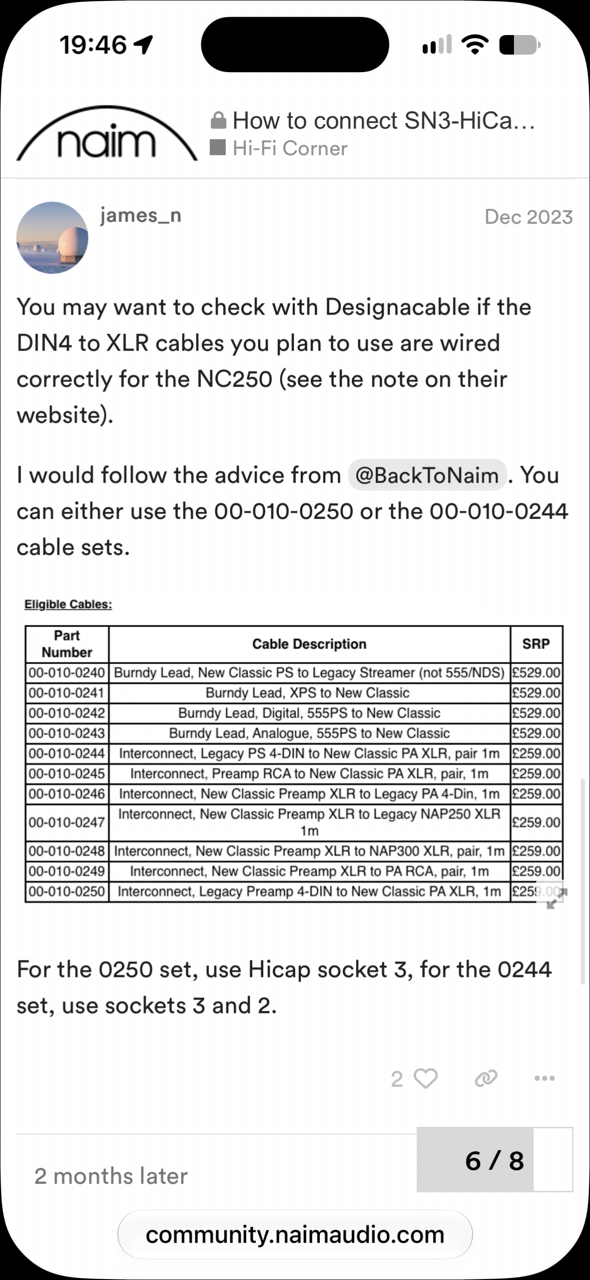

0244 will be fine as you have the two DIN4 outputs on the Hicap to use. 0250 is the Y cable you’d use if you didn’t have a Hicap and were using the biamp DIN4 socket on the SN3.
So basically i will need to order 1 or 2 pcs of 244 (know it says pair, just doublechecking)?
IIRC, the 0244 cables come as a pair, but your dealer should be able to tell you for certain.
