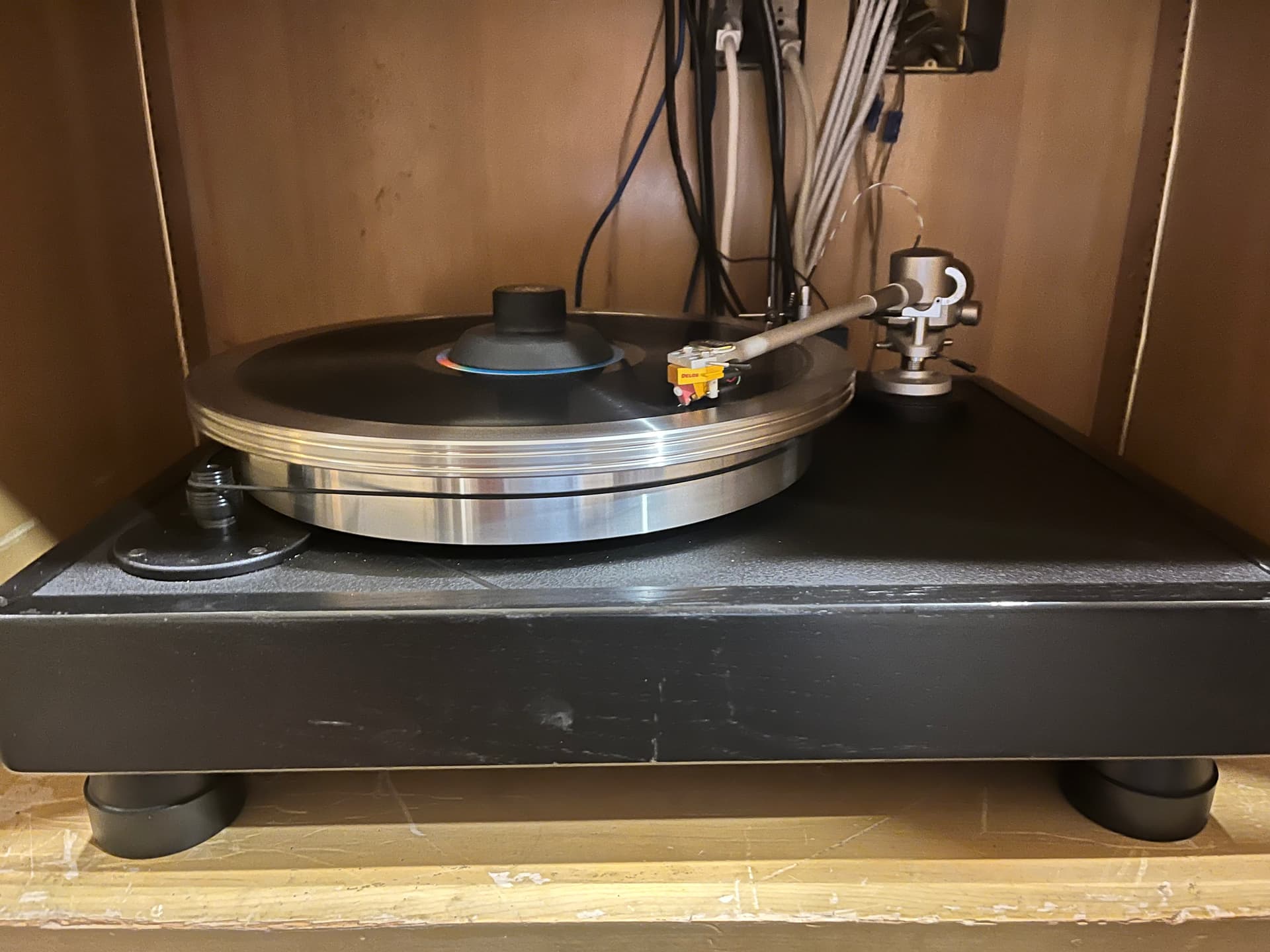

Here are some pictures for context. VPI has a little different philosophy than Rega, the platter is 20 pounds before the trim ring, probably another 5 pounds
