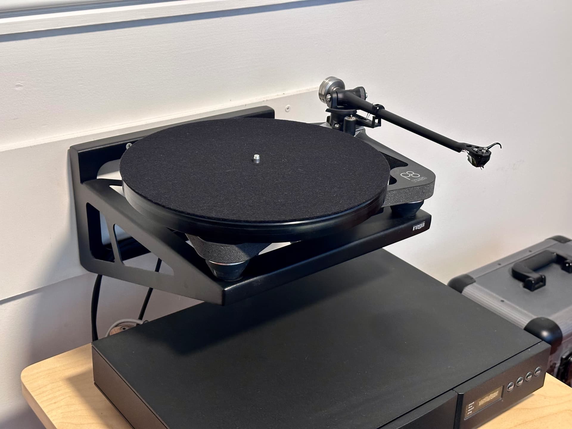

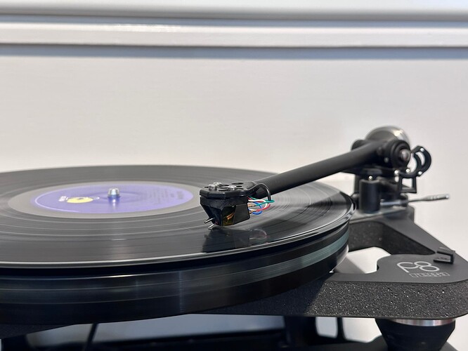

I’m using an ND7 on an old Rega P25 with my SN3 and it sounds great. My next move is to replace the P25 with the new Planar8 and put the ND7 on that.

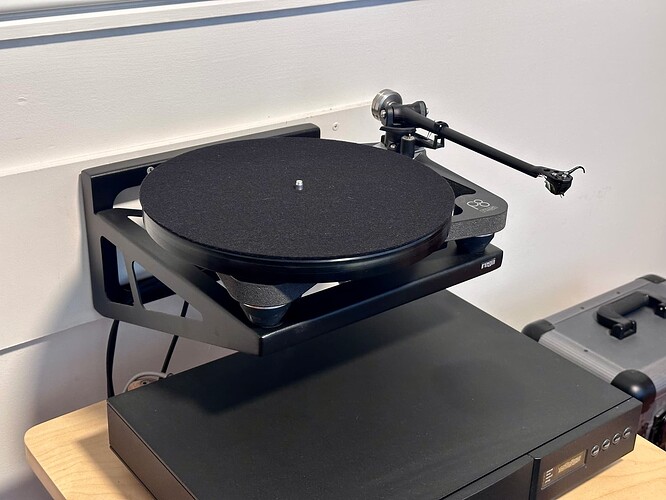

I have a P8 fitted with the Nd7 running thru the Supernait 3 built in phono. A match made in heaven. The Nd7 is fast. Rega highly recommended that you use a wall bracket for the P6 or P8. Note: Two different bracket models needed

Handsome looking deck! Very happy to read from others who have this deck and a SN3/HiCapDr using the built-in phono stage.
