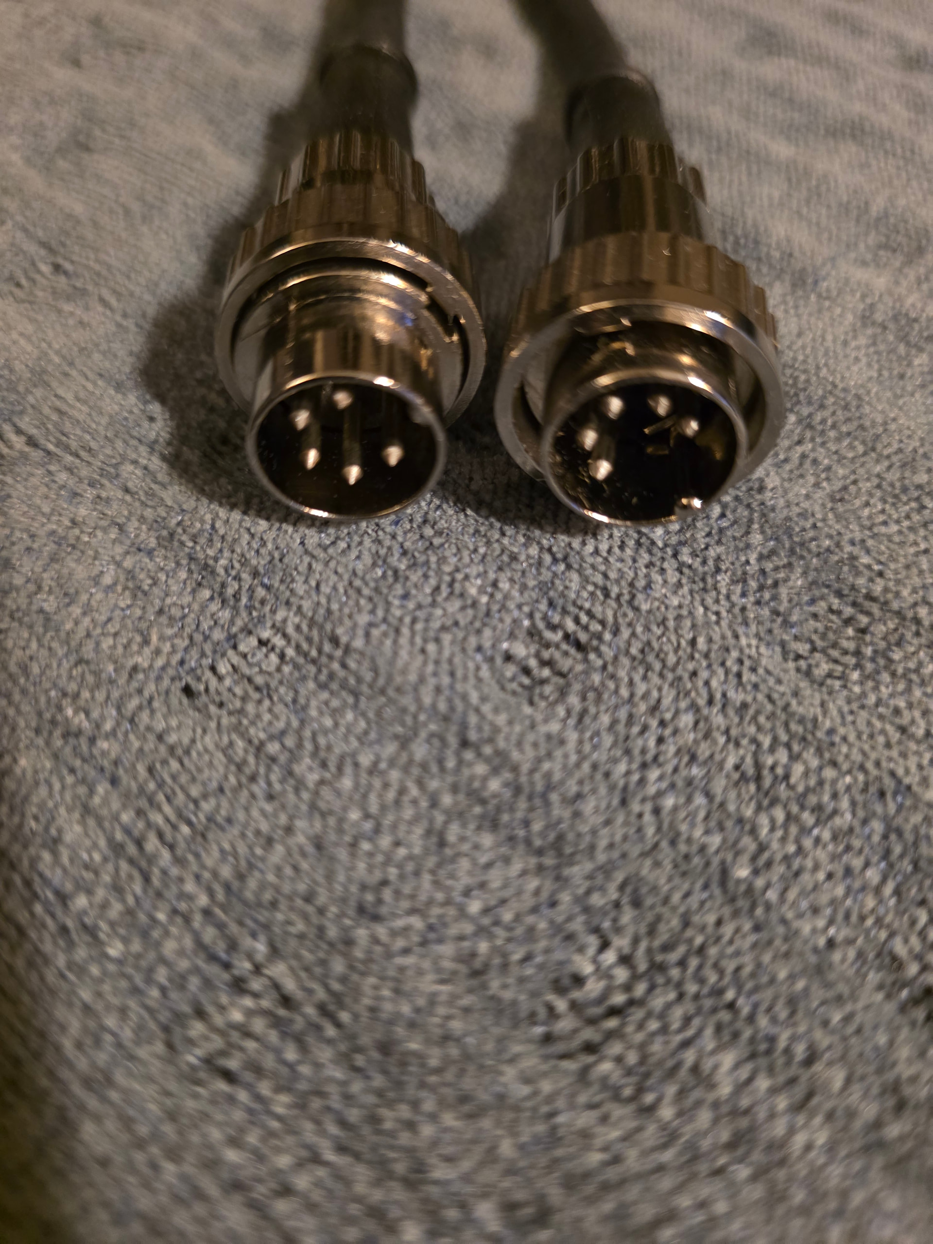

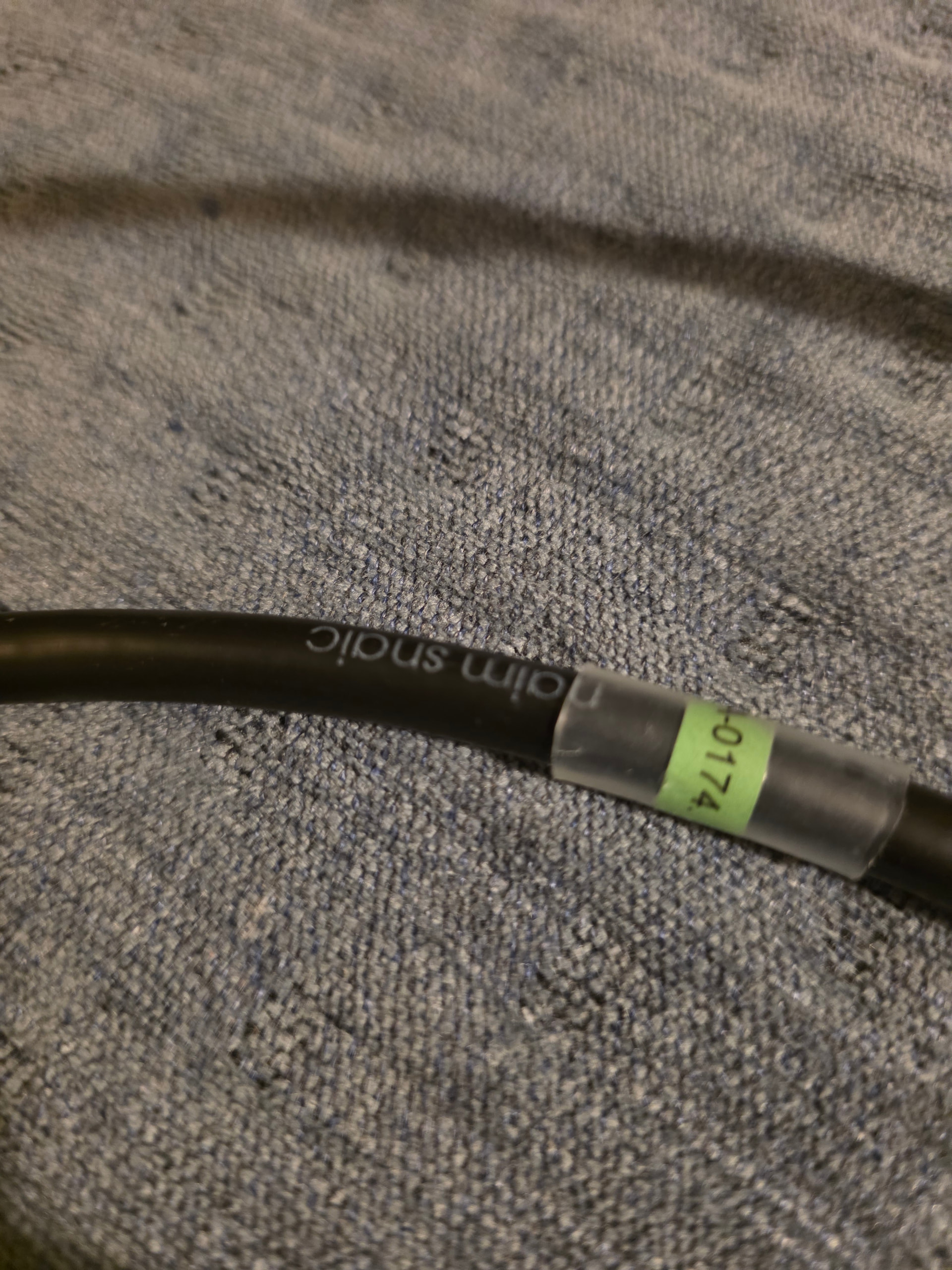

Confused about this Snaic that I bought on Ebay for my Nac 282 to Hicap DR connection. Was not cheap and looks legit but does not fit.
240 degrees on one side and 180 degrees on the Hicap side. Should be 240 on both sides.
Is this a modified cable or do these type of Snaics exist?

Looks like you got the wrong version SNAIC for your application, as you say, you require one with 5pin/240 deg on both ends.
I thought all 5pin Snaics are the same
I’ve never heard of a SNAIC with a 180 degree DIN5. 180 degree DIN5s are just for source interconnects. It seems someone made an error with this one. Is it new? I would return and get a refund.
I was thinking they had different versions but now not so sure, maybe I’m thinking 5pin to 4pin cables. Further thinking, 180 5 pin is for source connections? (Edit: as Richard just posted above, yes this is the case)

It is correct on one side and wrong on the other side. For a moment I was doubting hard earned insights into the Naim universe. Glad to hear that this thing should not exist.:grinning_face:

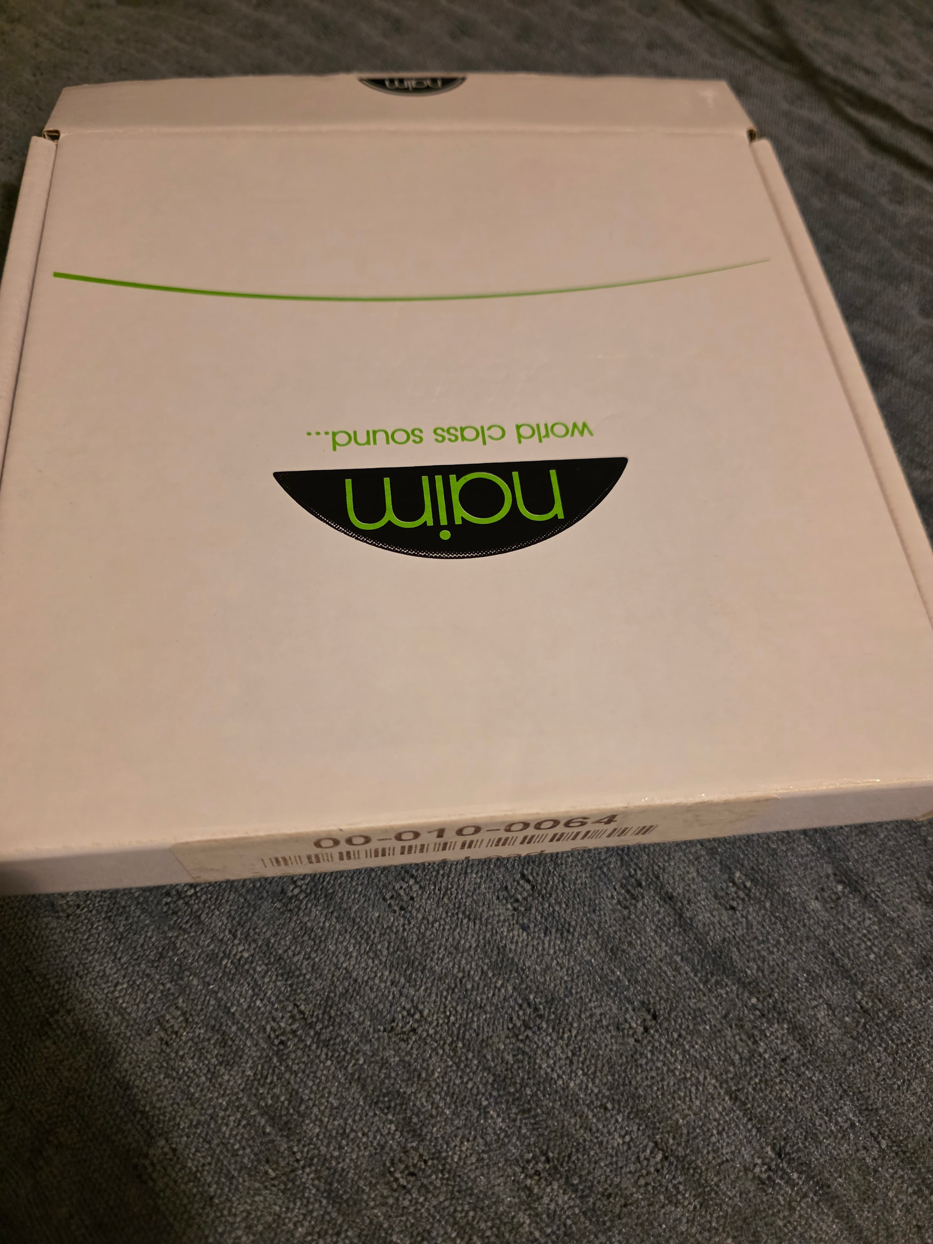

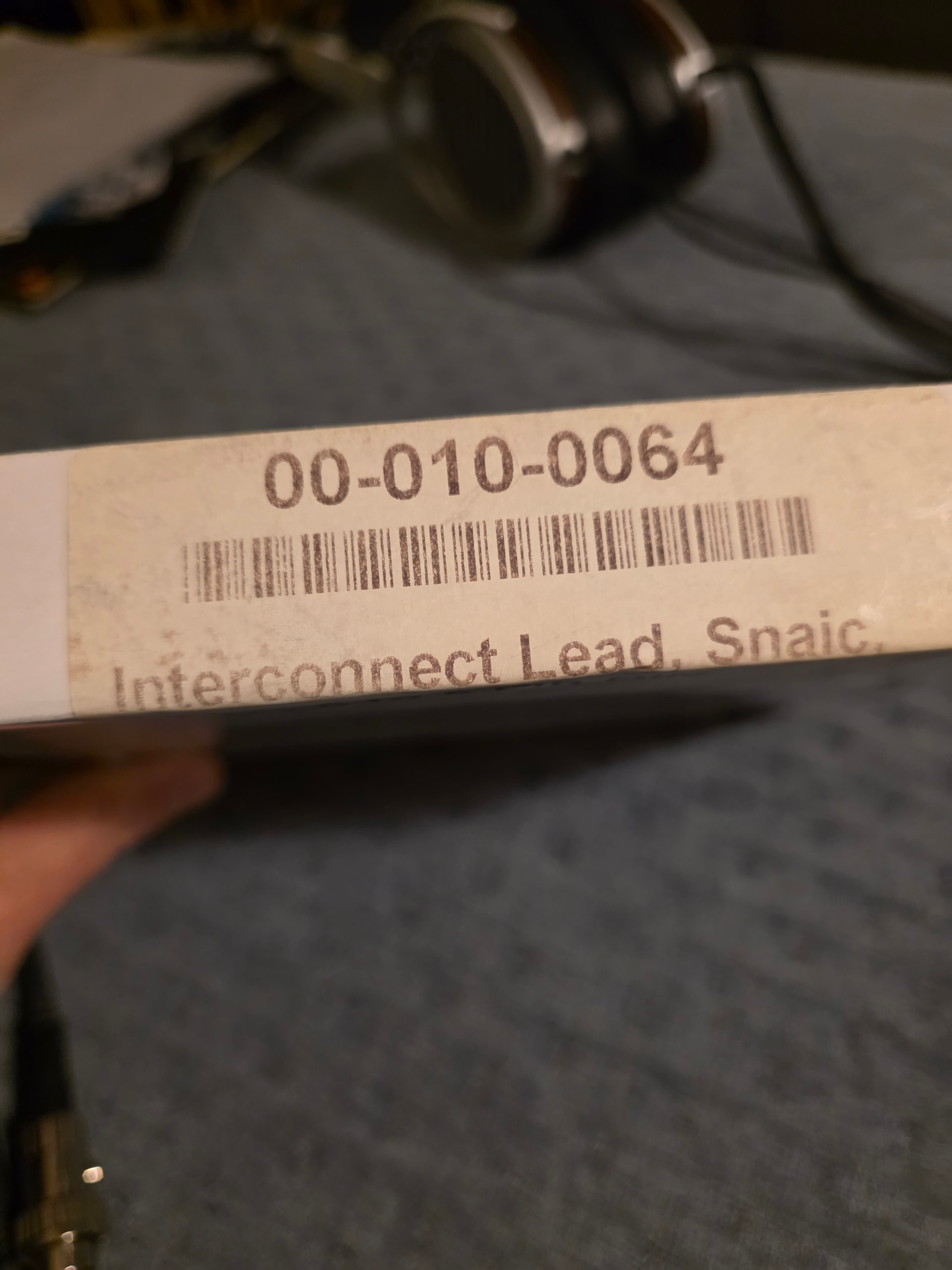

It is used from Ebay but came with original packaging and looks “unmodified”
I don’t think you need to ask a dealer ! Its clearly not a snaic with that 180 connection

And don’t plug it in. Depending on how or if it is wired, you could stick voltage where is is not required, and do damage to a source output.
Thanks @Thegreatroberto luckily it did not fit into the Hicap. The guy who sold it to me says that he bought it a couple years ago and never used it :thinking:. Will try to return it. Very strange indeed

Had to resolder mine. The cable looked fairly low grade as was the soldering.

There is no such snaic cable. Try to get a refund from the seller. Strange is that it looks very professional done
Thanks Drago. He already agreed. I told him that the Naim community is quite upset about this cable :rofl:
