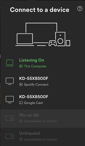

Unitiqute2 fw 4.7 and Qb1 latest firmware. I’m getting “Unavailable to control” greyed out on both of these when playing stuff on Spotify Premium on my iphone, ipad and m1 mac.
Any ideas? Thank you.

Solved. First, have performed a factory reset from the unit’s config menu. As I recall, it did not solved my issue. Then realized, both Naim units are greyed out as output sources when trying to play podcasts (with the video stream on). Once I switched to music files, the Naim units were displayed as viable rendering options. Podcasts can be streamed on the Naims as well, as long as the video feed is off.
