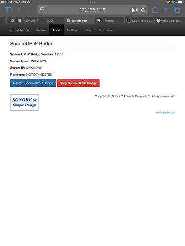

When I check the Roon Ready settings it shows only USB output as an option which I cannot change. The bridge app shows no server type or server IP and no renderer connected. Perhaps this is the problem, just not sure how to correct it.
If these images point to any particular issue any advice appreciated. Perhaps Sonore or Roon support is the next step.

Does your SonoreUPnP Bridge page still show Server type & Server IP as UNKNOWN?
Sometimes the ‘Restart SonoreUPnP Bridge’ button helps when it’s in this state.
