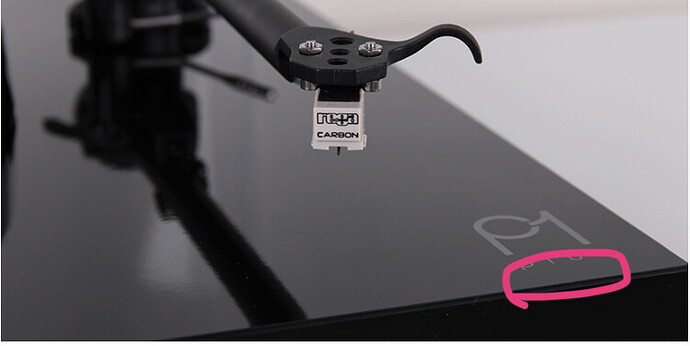

Are you sure it’s a Planar 1+, and not a Planar 1?
Does it say “plus” here?

The Rega 1 plus can be plugged straight into your Atom and you will get a tune if you have a Rega 1 then all you will you will hear is what you described
