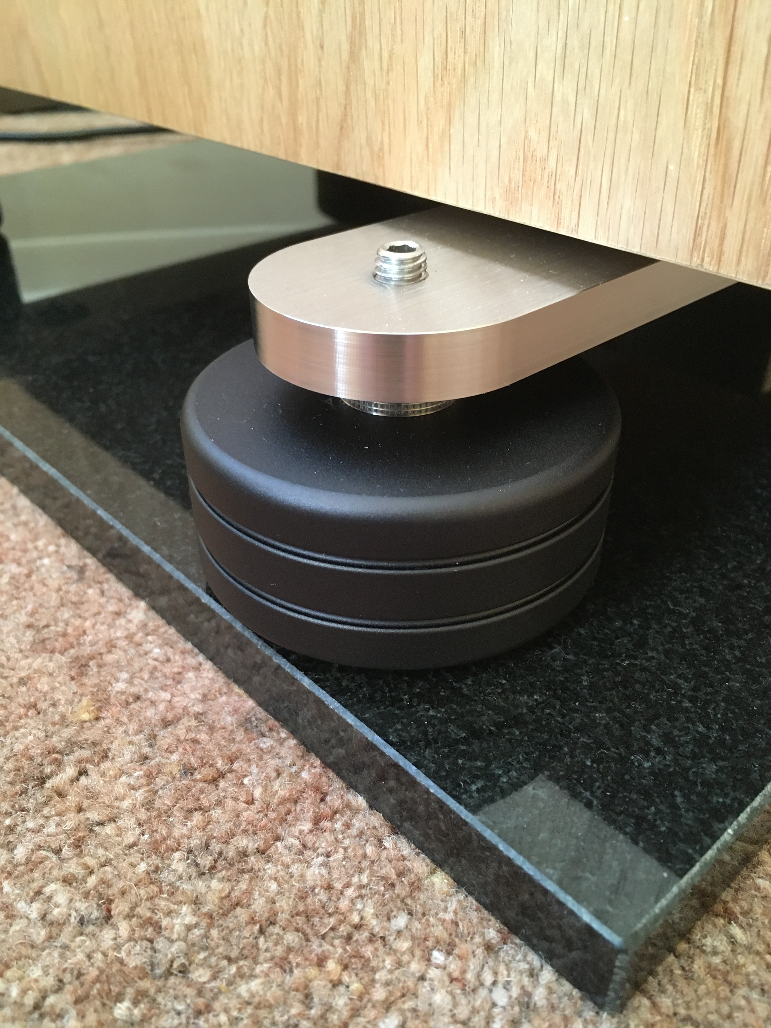

Hi @indexical
Here are my thoughts. I also own PMC Twenty5 26i speakers. I have owned (i.e. lived with, not short demo), Townshend Podiums and Iso Acoustic Gaia’s. My speakers sit on granite chopping blocks, on carpet and underlay. I have used the Podiums and Gaia’s just on carpet and tried the Gaia’s spiked into the carpet.
So here what I found. The Gaia’s gave me very little difference, whether spiked or not. Personally, I could not recommend to buy again. The Podiums are more noticeable, giving a greater 3D soundscape. In fact run the with the PMC’s and ATC SCM40A. They require a bit of adjustment to set up, but as long as you follow instructions, you should be okay. However, unless you have a cavernous room, there is no getting round the fact that they have a large footprint. Also, when ordering, the correct load cell, is just not the weight of the speakers. It should also include the weight of the Podium platform. A lot of people forget this.
So, in my humble opinion, the best isolation for my speakers is……Stack Audio Auva’s. I own the 70’s and just last week purchased the 100’s. They are the only system, that my wife noticed the difference, without being prompted or some visual clue. I have included some photos of various isolation products and methods, I have tried.
Townshend Audio Podiums
IsoAcoustics Gaia III’s
Granite chopping blocks
Herbie’s Audio Gliders.
Stack Audio Auva 70’s
