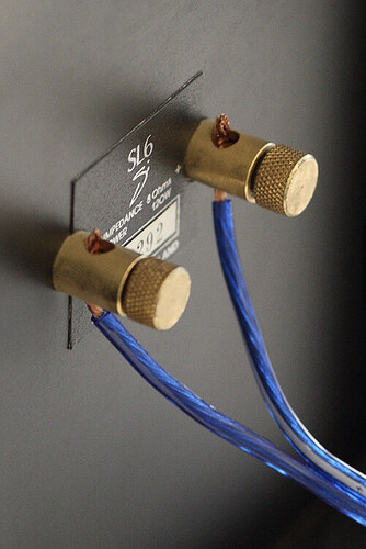

I am back and have reveled with my new to me modified Celestion SL6Si speakers with their ribbon tweeters and kevlar midrange/bass driver.
Being an industrial electrician amongst other more mathematical technical employments. When terminating signal wires and power cables we use a system of bootlace ferrules and copper crimp lugs. Though when using contactors for electric motor applications we generally use bare copper wire and the same for domestic light and power switches.
Now when it comes to audio, in the past I have just placed a small twist on the speaker cable and inserted it into the post and clamp arrangement on the rear of the speaker.
I am using Naim speaker cable and after trimming the insulation back the untwisted wire fits snuggly into a 4mm grey bootlace ferrule which I will supply a link to.
Should one use such a device or similar? I should point out at this stage the bootlace ferrule or crimp lug are professionally crimped using expensive industrial crimping tools. Not cheap eBay stuff. Or do we just strip back the black insulation on the NAIM audio cable and present bare copper into the speaker terminal. You may have spring-loaded terminals. Though in my case I have binding posts with a hole through the middle of the stem.
Here is an example of what I am trying to picture in your mind. The post in this example takes a 4mm banana connector in the end, Though it also has room for the bare or terminated copper cable to enter through the hole in the post and be made tightly clamped in the whole by the turning of the binding nut/thingy.
