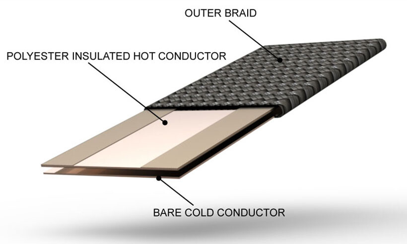

The specs of that Isolda look scary as anything for a Naim amp. Very low inductance and very high capacitance is exactly what a Naim power amp doesn’t want. IIRC this type of flat copper ribbon speaker cable was exactly the sort that Naim warned users not to use. Curious about the compensation network. I guess it must work if your amps are still OK.

I’m aware if at least one small manufacturer who will make up a small, inexpensive box that adds the required inductance, allowing you to use any speaker cable with a Naim or other amp that doesn’t have this built in. I’m guessing the box on the Isolda has something similar.
Its a zobel network, as far as i’m aware. I did use isolda with a nait xs; it didn’t seem to be affected, but i did swap to naca5.
I would guess so, but surely not having to have an inductance network in the path is the more elegant and logical solution. Still, I guess if it works and saves the amp from melt down then it certainly makes the cable more useable and commercially viable.
Surely adding networks to the end of an unsuitable cable to bodge it into suitability is simply adding links in the chain that don’t need to be there and cannot do anything positive to the sound.
The ‘cable’ is effectively an unrolled capacitor, two strips of flat conductors laid over each other.
