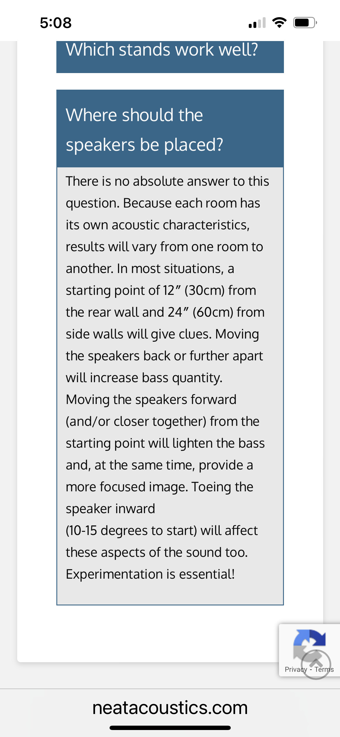

Does the Neat manual provide any positioning guide?

This is all they say.

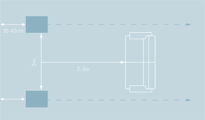

Kudos say - “Place your speakers in the position that would work best visually. Make sure they’re not too far apart, we recommend around 2m and at least 2m away from the main listening position for optimum sound quality.”
Kudos guidance -

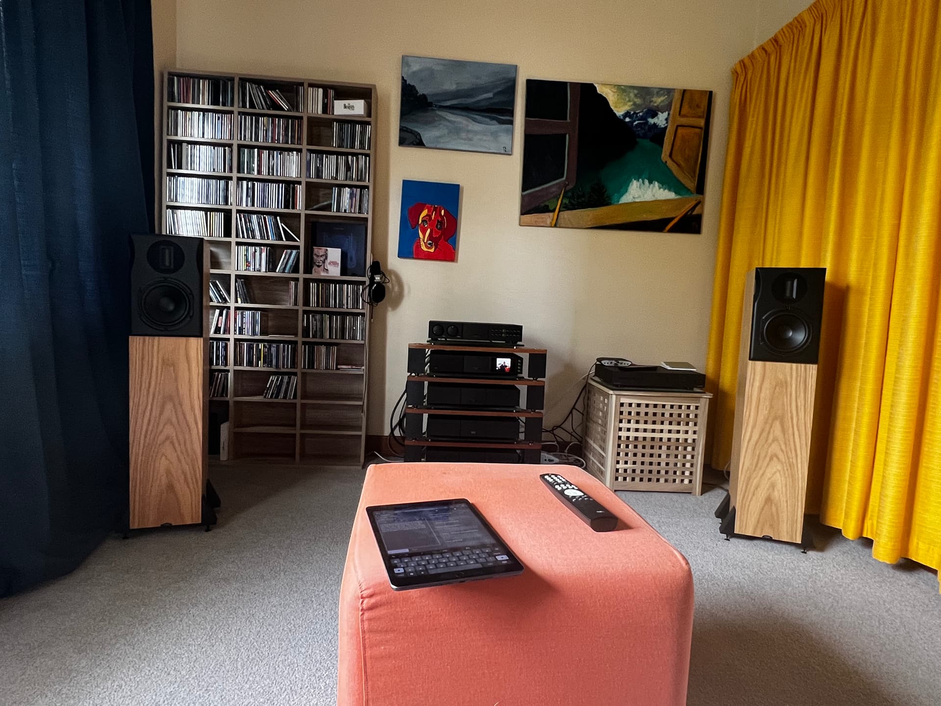

I use Neat SX3s. I have them toed in about 20°, and I sit close, as far from the speakers as they are from each other, so their axes “cross” quite a way behind me, I can still see quite a bit of the inner speaker face in other words. I occasionally try them firing straight, and occasionally entirely on-axis, but seem to return to what’s half way between those extremes - 45° would be on axis for my listening position.
I find it useful to try the extremes, as I’m not sure of my own ability to hear the difference. By being “silly” I’m happier that I can actually tell, and then go from there to find what seems right.
The (terribly blurred it seems!) pic below, looking straight at the left speaker, shows how much toe-in currently.
