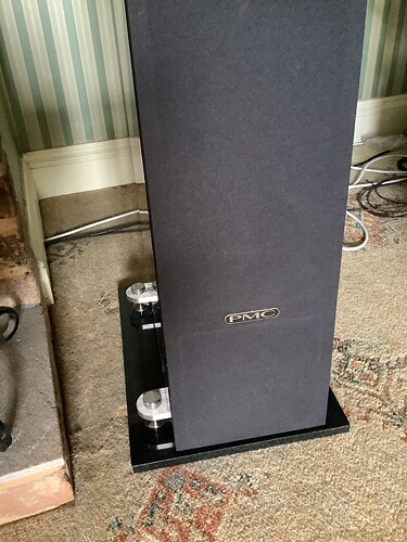

I have a 3 spike (small cones) on my speakers (DIY), 2 at the front 1 at the back. the only adjustment is to set the vertical on the 2x front spikes
Thanks Gazza, this is similar to my set up but I still get some wobble I think due to the lack of weight of speakers. Your PMCs will be substantially heavier than the neats I suspect.

Indeed 3 feet are tge best way of eliminating wonnle - including equipment on shelves, and racks on floors etc. But beware increased risk of knocking over due to weight distribution with typically rectangular bases, depending on weight distribution and centre of gravity. (milking stools are round not rectangular.)
I’ve been building speakers for a number of years & always use 3 spike/mount points
I always have x2 points at the front as its under the heaviest part of the cabinet with drivers on the front baffle. As most of my designs have a significantly greater front/back dimension than side/side measurement, they are super stable.
Although I haven’t done it for speakers (yet) myself, I’m fully with you on this - my cautionary note simply because it does depend on the speaker and its shape, including height, and I think some would be a bit precarious. When I had a TT I gave it 3 spikes for feet - so easy to adjust for levelness, and all feet firmly in contact. I’ve also done with other things using sorbothane hemispheres, positioned for approx equal weight load rather than geometrically.
