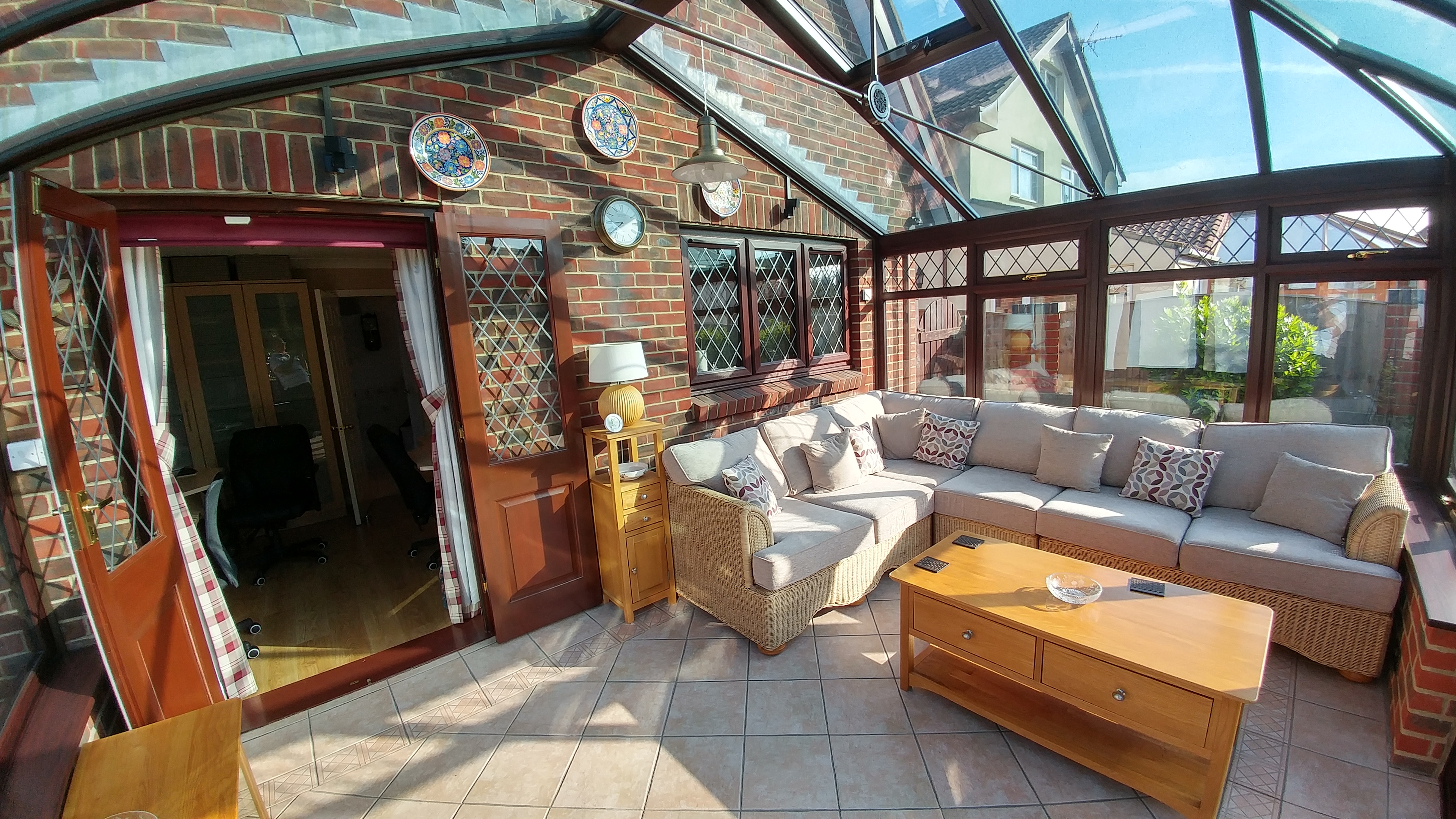

We use an old Bose Lifestyle 5 system in our conservatory. The system consists of a ‘music centre’ which is a fairly small pre-amp with CD and Tuner built in. A large powered subwoofer and a pair of tiny double cubed speakers. We changed the original cubes to the better Jewel cubes which can be found on eBay.
The control unit and subwoofer are located underneath the corner part of the sofa, the remote is wireless and it’s all fed by a Yamaha Musiccast WXAD10.
Whilst not high end it fills what would be a difficult room with a conventional system well and is ideal for background listening. It sounds pleasant rather than massively involving.
You can see the cubes in this picture, above the doorway and window.
