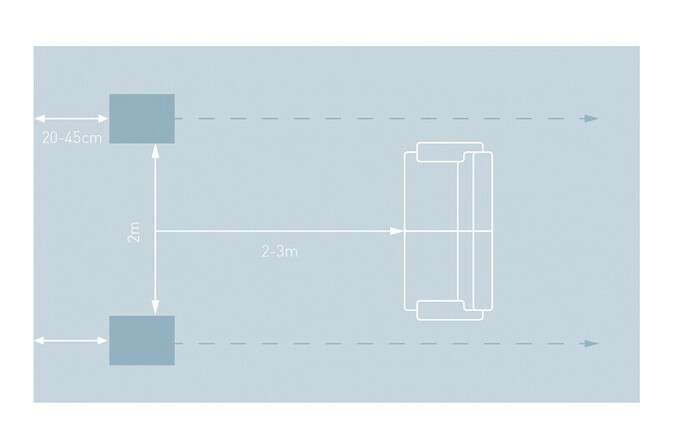

There’s quite a few Kudos speakers on here and they are designed to fire straight on without toe-in. Also work well close to the rear wall.

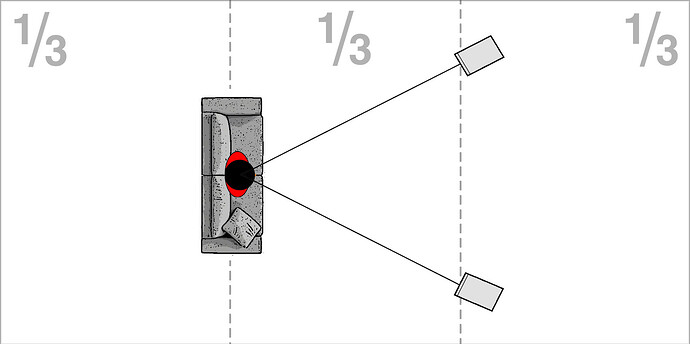

My ATC’s have a c30degree toe in and due to size of the room it’s a near field listening experience which works as I have a room allocated for music. The speakers are only 170cm tweeter to tweeter ergo I sit in close and by and large close to the rule of thirds.

I have Kudos speakers and just followed their advice from their website. Works fine.

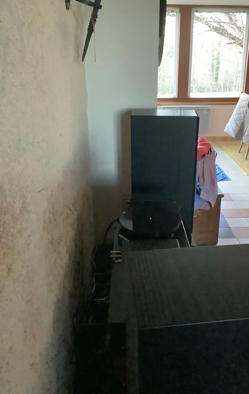

Leaving aside orientation and distance from front wall, one thing that has particularly struck me is the number of asymmetric set-ups. Obviously some rooms by their very design may make system symmetry impossible, but the pics show that sometimes things are significantly asymmetric even when the room appears to offer easy symmetrical placement). And not infrequently there is a side wall very close, with no arrangements to reduce the inevitable early reflections that will result.
