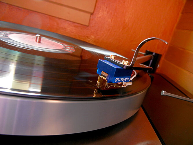

I used mine in an Aro. My impressions are probably still out there on the old forum. I’ll take a look…

As well as my own example at home, we ran a Royal N in an Aro at the factory for a while. It wasn’t without its little foibles. For one thing the separate “cheese” that mates between headshell and cartridge was not ideal and also somehow was the cause of some hum, finally cured by scraping the anodised layer and running some thin copper between it and the headshell. The weight also meant that the heavy counterweight was needed and some extra weight on the the bias too. However, it did sound good and had a bit of the meaty, beaty, bouncy sound that many modern cartridges miss these days. If I have a particular issue with it, it’s that the tracking is not that great and a high level cut can catch it out.
OK thanks Richard. A bit more eff mass could possibly help with the tracking and my arm is insulating so I’ll have to see about the hum.
I think that the SPU, like many old-school MCs, is ultimately limited in tracking, whatever the arm.
