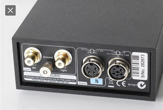

Bought the Stage Line at an auction site (winning bid!
) But how do I know if this is a MM or a MC setting?
MM will say N on the back, MC will say S or K.
Check the sticker. N equals MM, anything else MC
E - For use with MC cartridges: 400uV/560Ω
K - For use with MC cartridges: 100uV/560Ω
N - For use with MM cartridges: 2mV/47kΩ
S - For use with MC cartridges: 100uV/470Ω
Thanks ! It Says N = MM . Will fit perfectly with my Ortonfon OM40 Super or 2M Bronze. All I have to do now is save up for the Snaic cable (pricy but the Stage Line was 150€, so .. ![]()
