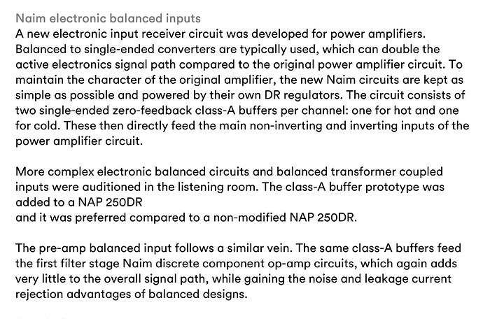

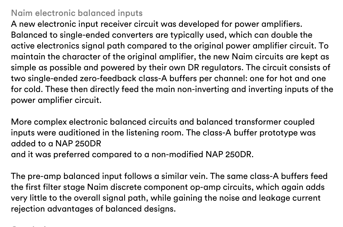

Maybe the confusion related to Class A come from here (Naim white papers)
My amp is rated at 185w rms, actually apparently first 18w Class A (nominally all music except peaks over 101dB with my speakers) and capable of continuous 200w. Not quite as powerful as a Statement!
An interesting read. I’ve always preferred the 333 to 332 via XLR than Din, regardless of naim’s recommendation for the latter. Perhaps that’s because I’ve always used balanced out from the 332 too. Who knows.
