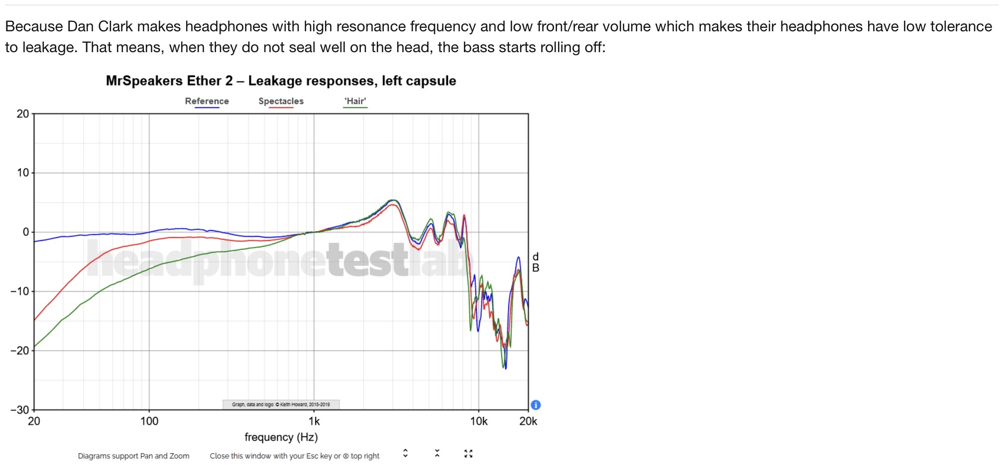

I’m glad that’s passed for you I looked up to see if I could find anything but just this little online test.
