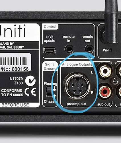

I have no idea which cable is attached to NAP 250 (if any) and what is needed for SU-NAP 250 quality connection.

I’m assuming you’re talking about the previous generation NAP 250 rather than the New Classic 250 that’s just been introduced ?
If so then you’ll find the 250 is supplied with a DIN4 to XLR cable. Use that to connect the 250 to the SU preamp out socket.
As James says, Naim provide a suitable cable in the box with a 250. If buying used, always check that the seller has remembered to include it or you will need to buy one.

It’s simple to use a cable with 1 end for the su and 2 ends for the 300. You wouldnt need to replace the su.
4 pin din on the su end, a pair of 3 pin xlr on the other end.
Should be the standard 4 pin din configuration same as eg hicap

Hi Robert, it is a great new .)) would You advice the suitable cable, please ?
