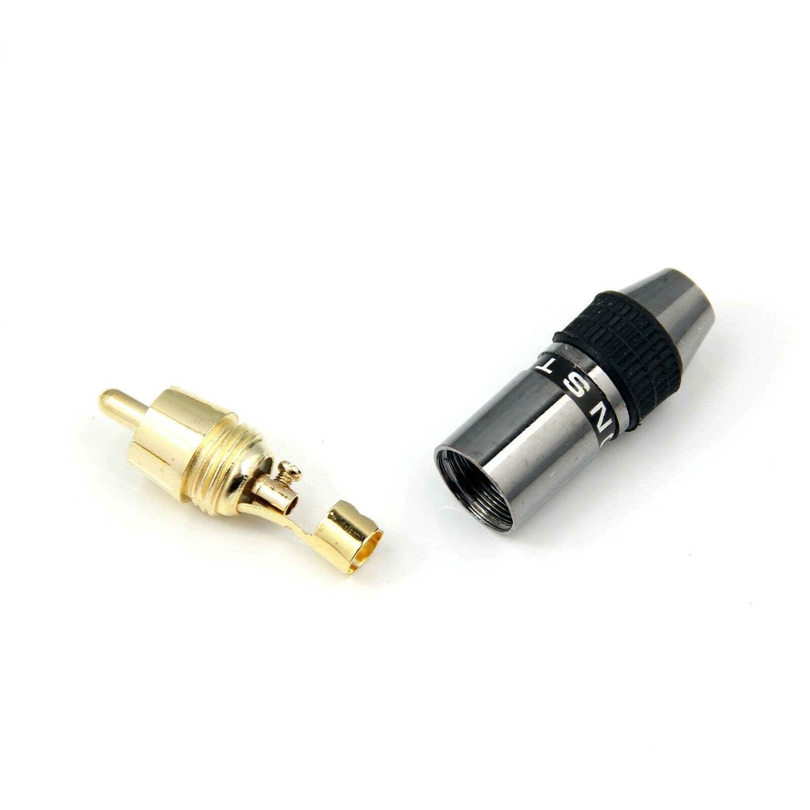

I have soldered a length of spare speaker cable to the plugs on one loudspeaker but now need to connect to the Hi level (‘line input’) sub sockets, and these use RCA connectors. How do I attach my speaker cable to RCA connectors? I am confused as each RCA socket obviously has two separate elements, the pin and the sleeve.
Is this what I need?
Thanks.

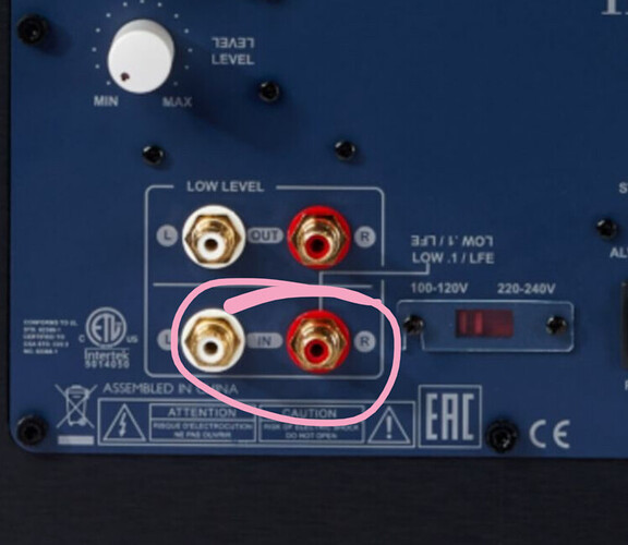

I use a UnitiStar and it has two Preamp Outputs (L and R channels). The sub has two inputs, one labeled LFE (single channel). The other one is unlabeled. I have connected a single 2xRCA cable to the LFE input on the sub and to one of the channels on the Star and it works fine with excellent bass rendition. BUT it bothers me that I only use one of the outputs on the Star. Is it okay with only one cable (it certainly sounds so!) or should I use another cable for the second output on the Star. Will I get an even better bass rendition that way? This is perhaps a non-question, but I wish to sort this out anyway…
LFE is for the .1 channel of an AV multichannel setup. It should not be used for full range music input. What is the subwoofer make and model?
Like this?
Use the lfe socket for the .1 in a 5.1 system.
Use both of them in a stereo system.
