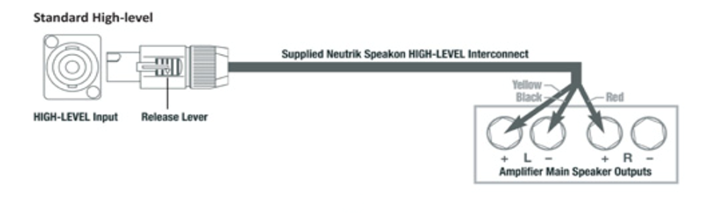

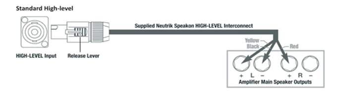

Was just going to connect it like this??
The spade connectors on the Bassline Blue will be no use on a Naim amp. The amp will not spontaneously explode if you connect it to the amp, but it may have some effect on sound quality, depending on the speaker cable you are using for your main speakers. The Naim specific Bassline Blue may be a better option here, although the connections do look a bit wobbly.
Yes. But you will want to use the naim version and bananas into the stacked bananas.
