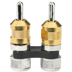

The Naim version does not have spades, it has stackable bananas so that you can plug the bananas on your main speaker cables into them. Otherwise there’s no way to connect both cables to the sockets on a Naim amp.
Yes, this is what you need if you want to connect to the amp.
If you were to connect to the speakers you would keep the spades.

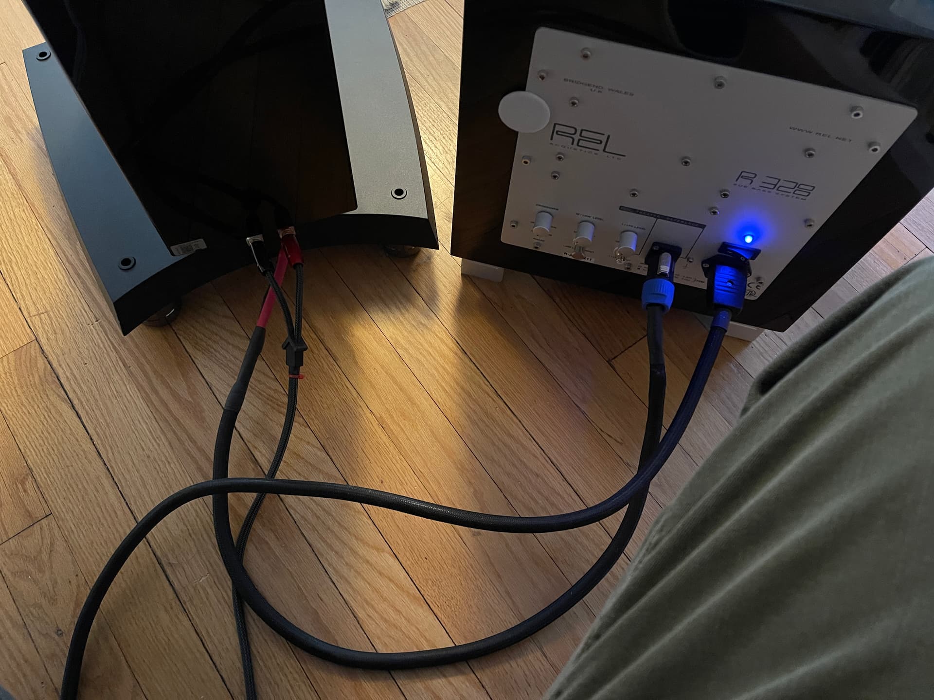

My speakers are the ProAc D2Rs. They benefit from a sub or two but only a smidge and the RELs were perfect and provided the bass control. I bought two REL T9is and connected them at the speaker binding posts with cables from custom design-a-cable. Aimed at competing with the REL Blue you can specify bare, spades or bananas. They are beautifully made and finished.
Maybe. Depends on speaker. Mine have the WBT interface with both banana and spade receivers. It just so happens I use the banana connectors for the amp and the spades for the subs, but there is no reason it couldn’t be the other way around.
The OP has B&W speakers which use dual purpose sockets which accept bananas and spades, so there would be no need to change the spades.

I have two REL T-zeros. Each just connected at the speaker end. But I am using 135s which are stand-alone mono blocks and this is of course a very simple situation.

I also have 135s. If I remember REL normally suggests 3 wires are connected on the neutrik cable - two red and one black, but the second red isn’t mandatory. That for one sub. With two subs, do you have just one red and one black for each sub? How was the positioning and set-up please?
I have two subs connected, one at each speaker. On each one the red and yellow sub wires are combined and connected to the red speaker terminal. The black wire on the sub cable is left unconnected. That is how I was told to connect them for my 300DR and Dyn speakers.
I position each behind the speaker and toe it in to point to the opposite back corner of the room.
