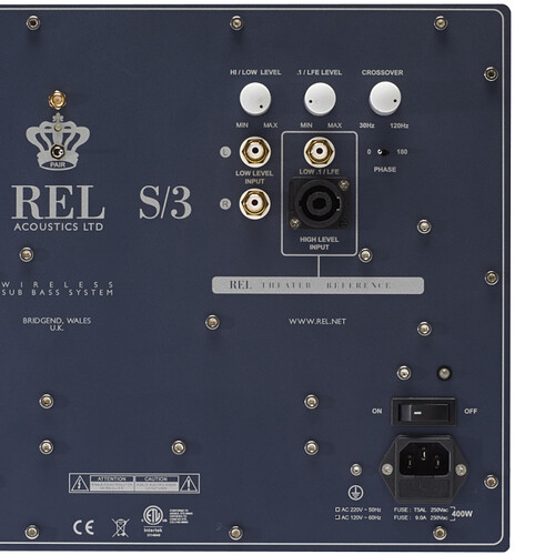

REL subs only have one low level input as they are primarily intended for home theatre use rather than for stereo music. This is how their amplifier boards are designed. Even their high level inputs are severely compromised for stereo use as they have only a single 3 terminal connection rather than using entirely separate connection for each speaker (if you think this isn’t so bad, think of a bridge mode power amp like the NAP500 or one of many others!).

@Xanthe Actually you are wrong. First off REL are not know for Home Theater subs, but as they put it they build Sub Bass systems. I’d hardly call the G1 MK II , or the Series S Home theater subwoofers, they certainly can be used for HT, and they do make subs for home theater but that’s never really been their forte. REL’s design is to use a High Level out from ones amp (int or power) the REL cable has three leads..one is red/right, one is yellow/left, one is black common ground.This is a very high impedance load I think 150K ohms so it does not affect the amp it’s used specifically to match the Sonic Quality of the amp’s output to the RELS input to better match sonics. The REL’s use a Speakon connector for this. The RELS have only a Low Pass Filter, which is set to extend and compliment the bottom end of the main speakers. Other companies may use a High Pass filter but REL’s are designed for the main Speakers to run full range and the REL to blend in from the bottom up, picking up where the mains roll off. REL’s do have a Low Level input that is used with AV Receivers as a LFE input if so desired, or preamp outs.. I don’t know if you’ve ever heard a REL or owned a REL, or setup a REL, I suspect not. Might want to read up a bit before speaking about something you appear to know little about.

Yes the ones higher up the range (now) have two low level inputs.
