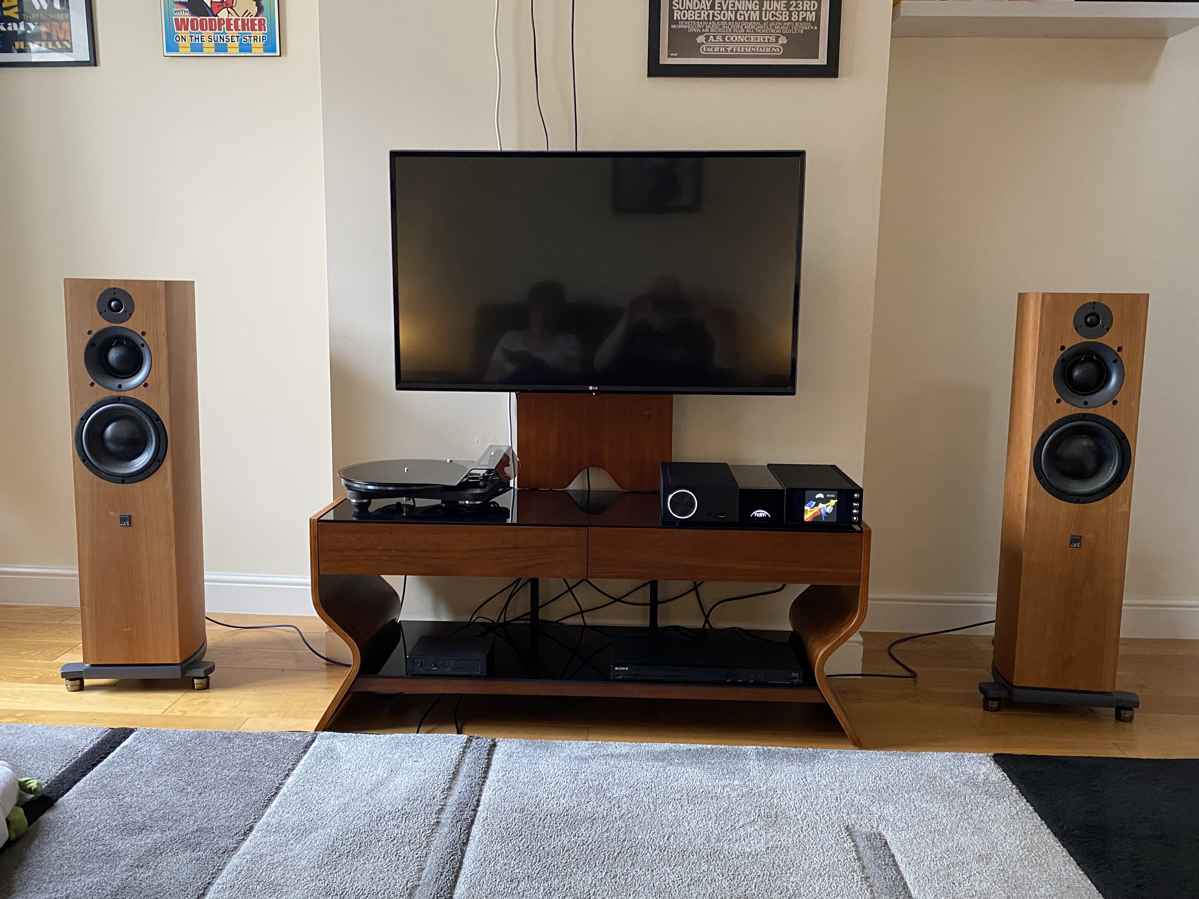

Hello Everyone,
I’ve recently returned to the Naim world having purchased a NSC 222. I’m using it with a pair of ATC SCM 40A’s and a Rega P8.
I’m finding the system a little bass light and was considering adding a subwoofer.
I was thinking about a REL Classic 99 or possibly a pair of HT 1205’s.
Has anyone done something similar?
Would be grateful for any advice.

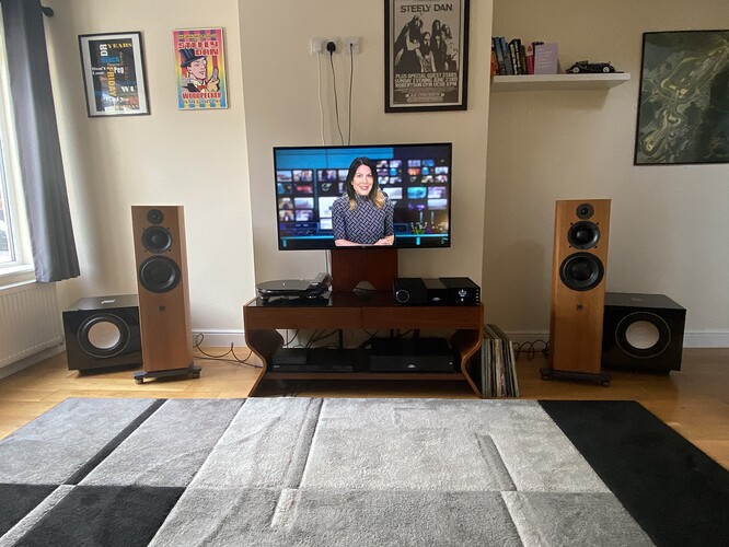

Here’s my current installation..any thoughts welcome :+1:
This topic has been discussed a lot here and reviewing past forum threads will be helpful. Here’s a helpful thread. There are 186 posts in it, so surely some helpful information in there. And welcome to the Naim Forums!
Looking at the connections on the rear I’d suggest a couple of things. Better power cords would help. if you’re a Naimie maybe try the Naim Power-Line cables. And it appears that they get Signal via XLR cables? try some better ones maybe Chord or whatever you ATC guys like.
Also I can’t tell if you’re using some type of AC Power Distribution unit??
If that doesn’t fix things then a REL Sub or a pair of Classic 99 or S/510’s will absolutely give you more bass.

Many thanks to everyone who offered advice and opinions on my post.
On the basis of those I’ve installed a pair of REL S510’s into the system today and my initial thoughts are that I have achieved exactly what I was hoping for.
I’ve not experimented much yet with positioning but right from the outset they sounded amazing, not only in the bass but also the midrange as many of you commented.

You seem to be watching the news in the photo - I’m not sure extra thunderous bass will be helpful with the world in its current geopolitical state!
