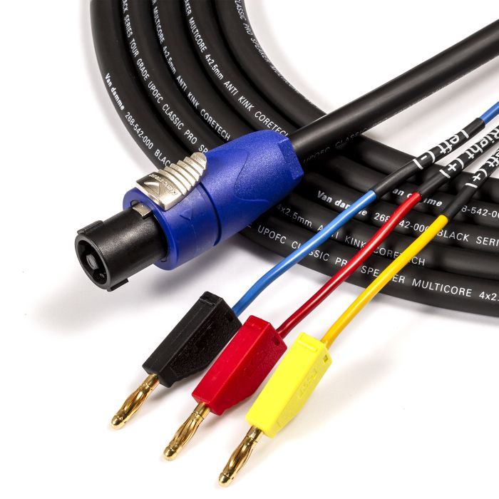

If you get one of these designed for naim/rel cables it is very straightforward to use the high level input. I have a T5Z. Very competent and small. I now use a bigger ReL, but have no problem recommending the T range. I must get round to moving the T5 on along with some other stuff that is catching my good wife’s eye as occupying real estate.
