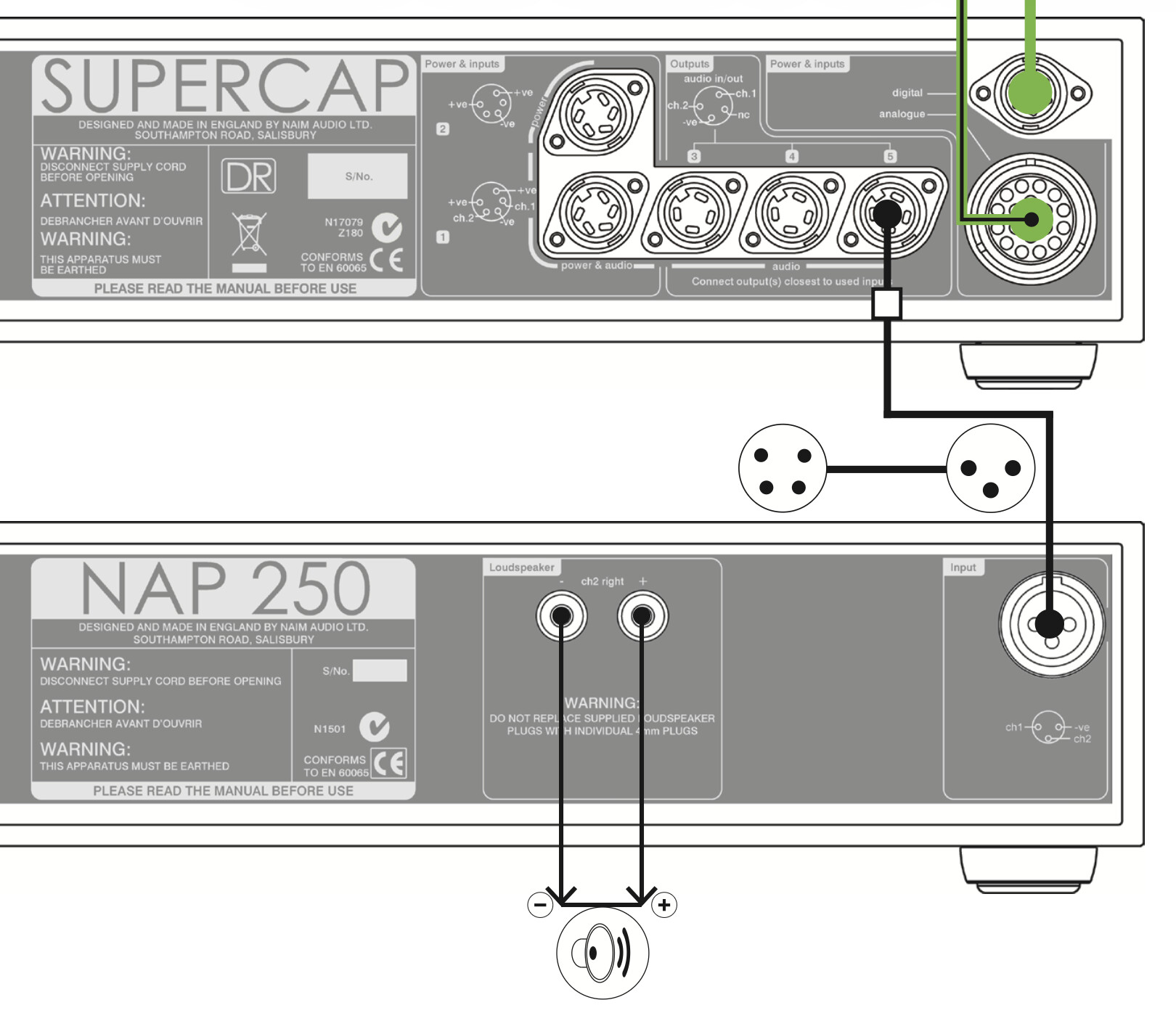

In a system with nac 252, supercap dr and nap 250.
Please could you confirm which socket on the supercap dr should the nap 250 be connected to.
If you could supply a photo that would be great.
Thanks

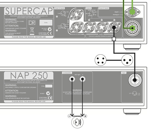

On the back of the Supercap it says ‘use output closest to used input’, so with a 252 you should use socket 5 for the 250.
If only Naim used such clear visuals for the connection guide!
