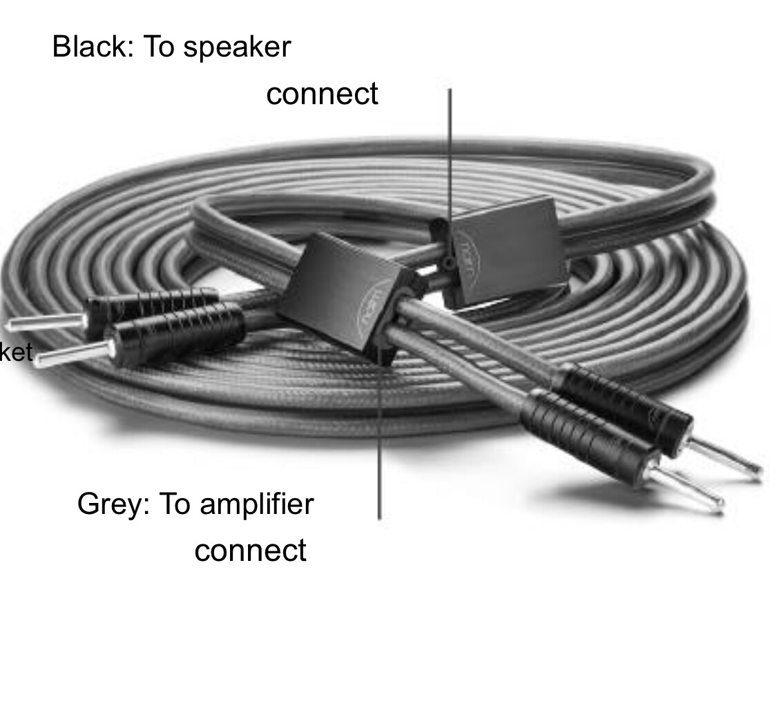

I found a German manual and translated it to English.
For anyone who needs the info:
Sorry, I should have been clearer. The gray/black distinction is the inset within the black ferrite box that the cables pass through.

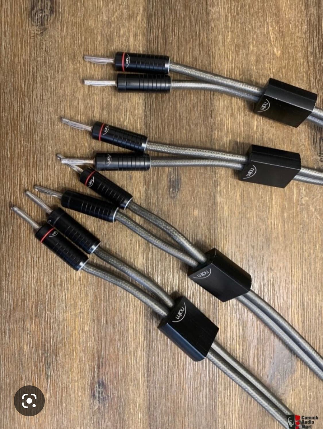

I think there should be only one end of which the red cable is from the left and 3 other ends which the red is from the right.
Mine are: two ends with the red on the left.
Here is a picture that I found and I assume it should be like this:
@Richard.Dane can you please confirm?
Just connect the red pin to red socket at the speaker and amp, and the same with the black.

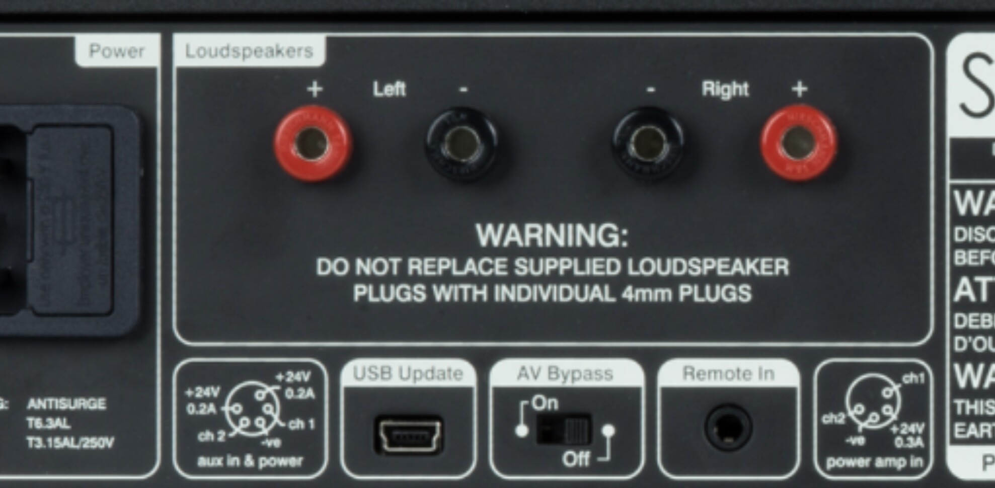

The sockets on the amp are mirrored with the black innermost. Most speakers are not so it sort of makes sense except for the amp channels being arse about face.
As Mike says, just connect the red banded plug to the red/right/ch2 socket. Be sure that the box with the lighter grey insert is closest to the amplifier.
