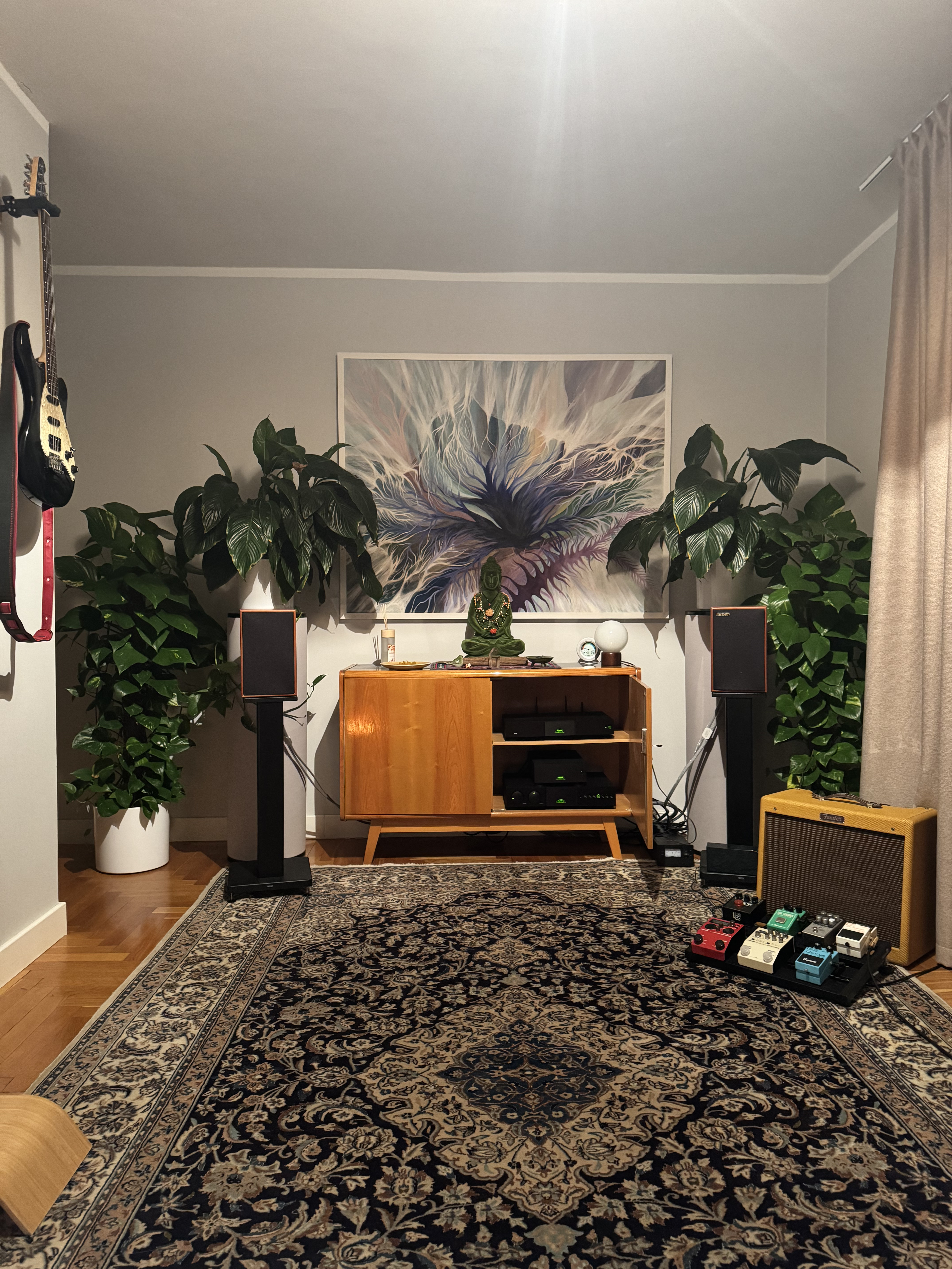

Hello everyone! That’s my first topic at the forum:)
My system is this: Naim Nd5 --XS2-Supernait 3 +HiCap DR - -Harbeth P3esr - and 12m room.
After switching through a couple of settings, I’ve ended up with Naim gear, mainly because I’ve found it gives the most natural sound to my taste, not so ‘audiophile’ (slow somehow) as some other I’ve had, but more realistic and present. Harbeths were chosen after testing just a few others speakers some years ago - before I’ve had Revolver Music 1 speakers which were very good for it’s price, and I’d say just the bass, which was tighter was better than in Harbeths. Now I moved to the other flat, and wondering what would be the next step at improving the sound, I’m still missing some control over the bass, maybe some high tones could be slightly emphasized too. Thinking about either changing streamer to NDX2 or speakers- but not sure which would be the right choice for the room size. Should I consider Harbeth 7es3 (aren’t they too big?) or 30..or maybe try something different, like Neat for a change? (haven’t heard them yet). However I wouldn’t resign with that midrange and ease of listening. The money to spend is around 3k, I’d rather go for a second hand. The cables I’m using are Albedo monolith (silver) - RCA is far better than standard Naim DIN cable. I had to adopt the room a bit as the acoustic was terrible, lots of reflections, even when talking. Any advices will be very appriciated. My instinct tells me:) that Harbeth 30 would be the optimal choice but maybe I’m wrong, and should consider some other option to go. Attaching some photos of the room.

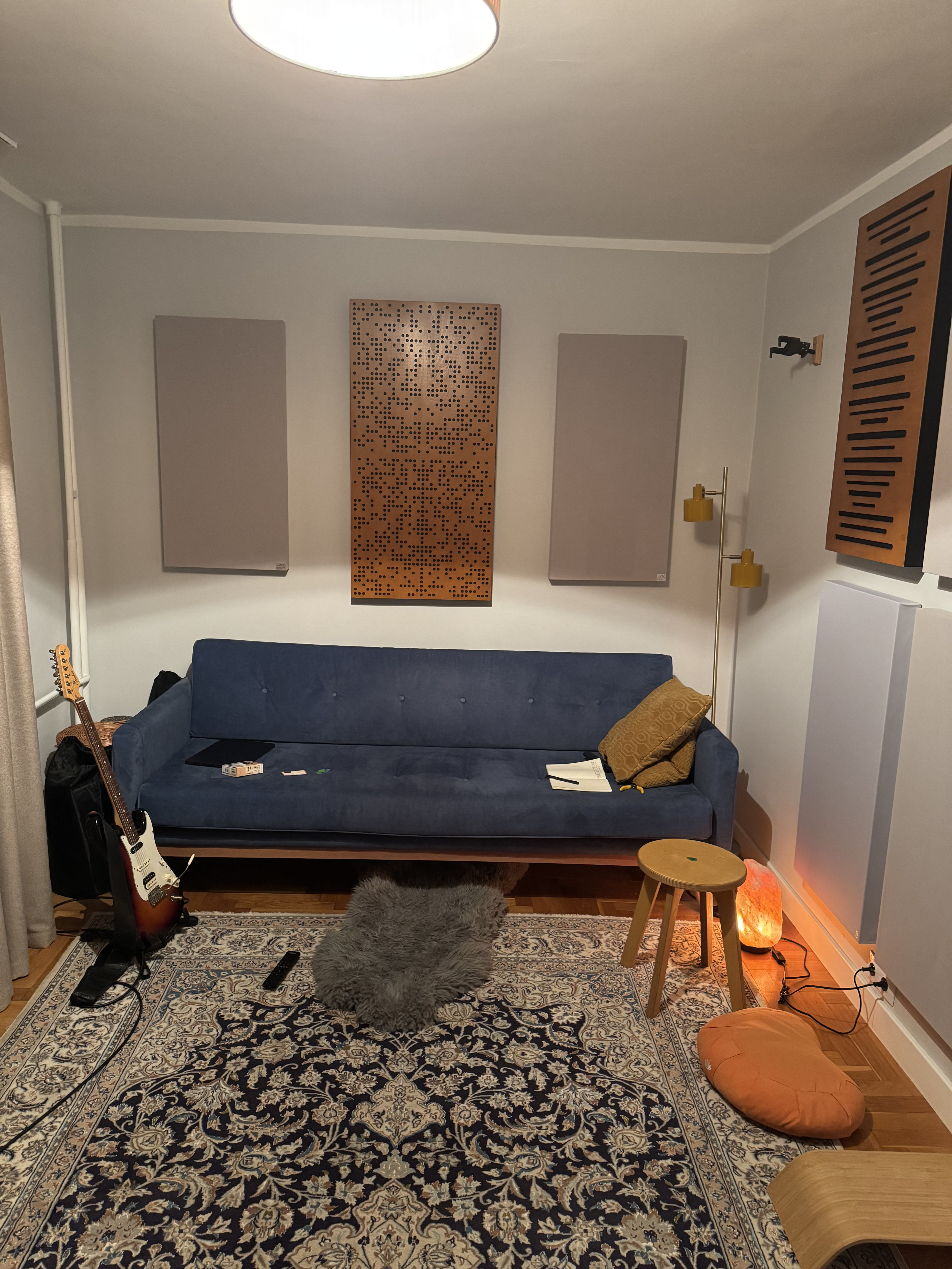

At least from the perspective of the photos it seems that the room is relatively narrow and long with the sofa at the long end of the room - have you tried listening from a closer distance e.g. somewhere in the middle of the room?

I’ve just measured the room and it’s 3x4.6m so actually it’s almost 14m;) (I don’t know where 12m came from;) I moved column a bit forward and the bass seems to be tighter now and overall balance seemes to improve, I’ll check it properly later in the evening but that would be a cheap and easy upgrate. Can’t go with it too far though, as there is an access to the door on the left side.
Ok, it looks like I can rather hold on with changing speakers, which is good;) Yes, I didn’t consider that bigger speakers besides the bigger sound might be just too close to each other. The photo shows as current Harbeths p3 very tiny, but in real they look right and not that small.

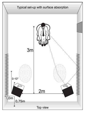

If you are able to experiment, try placing the speakers on the long wall and listen in near-field. In small rooms I often find speakers to sound better when placed along the long wall with more space from the side walls (>0.5m). I also prefer speakers to be placed further apart from each other.
I’d probably try pulling the sofa forward about 15cm and seeing how that is.

Dear Norbert
Based on my own test / experience with different systems, long wall ..if possible…is definitively better :slight_smile:
  1. Keep a min on 30 cm behind your sofa / rear wall
  2. More a less the same from back of the speakers / front wall.
  3. Ratio speakers distance / listening position comprise between 1.0 to 1.6 will give you a very good soundstage with enough focus. Tow in a bit could also be used for fine tuning to your own listening preference, room frequencies.
Wish you lot of fun.
Yes, I need to seat further, around 1m off the back wall, that gives best sound, so mostly …I’m sitting on the floor:) Than the tweeter is too high…so I’ve tilted the stands down on the spikes:) Still not optimal but I do what I can to compromise.
Thanks Ris, that’s what I am actually going to do. I forgot somehow how important that setting is, I’ve just put speakers so they look right, also thought that I can’t move them more forward, because of access to the door but it looks I still can. And just that quick move causes that clarity and blance, especially bass improved. I’ll do the proper check and find the best spot, I just must be in the right mood to do so and well rested, my hearing improves significantly than;)
Long wall is no option here, I’ve tried it once and the room looks odd and not functional. The good thing is, that this wall on the left has been added a few years ago, to make 2 rooms of 1, so if I decide to stay in this flat for good, I can make one big 25m saloon:) And that’s going to be game changer. But it’s not the case at the moment, and for now I’m just getting the most from what I have. Thank you for the advices, as mentioned above I’ve forgot somehow about aspect of setting the speakers:), will play with it but just a quick move fwd brought already some positive changes.
Guys, I’ve found good spot, acually a bit further, but not too far, an my system have never sound like today:)) The best sound I have heard. Listening Pet Shop Boys now like I can properly understand and appriciate that music evetually. Lots of colours, great rytm, great balance of tones, just pleasure to listen like never before:)) Happy bunny
