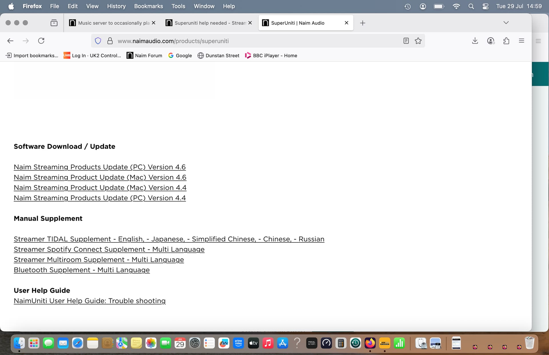

Thanks David, with my SU and UQ2 currently off, I checked the Naim website, photo attached! How long has it been since the forum were first highlighting these issues?
@Richard.Dane is there yet to be serious progress on correcting or updating information on Naim’s website?

As @sound-hound says. Naim do a special lower service price if it’s just screen change, about half what a service otherwise costs. The reason they have to update the firmware is that the current screens read backwards unless the newer firmware is installed!
I’m next down there in August for the forum visit and it’s one of the items on my agenda to ask James while I’m there.
