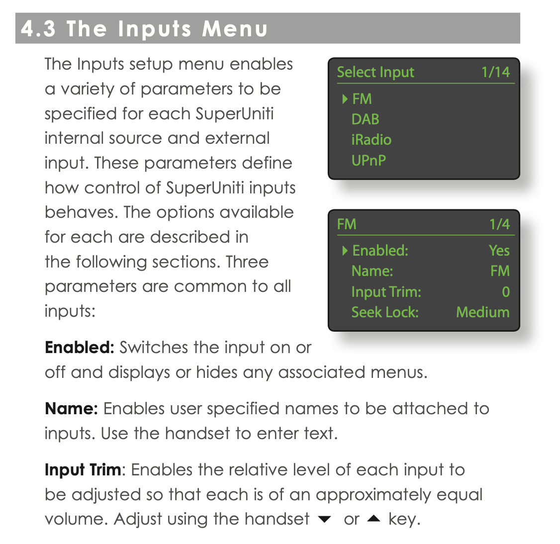

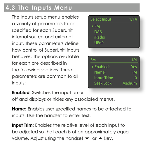

You should adjust the input trim for the phono stage input to bring it up to closer to the CD input. See the manual;
OK, thanks for the pointer, I didn’t see that in the paper manual. I will explore.
Yes, after initially trimming the wrong channel (! don’t ask), I eventually succeeded. set it to +7db, much better, thank you.
