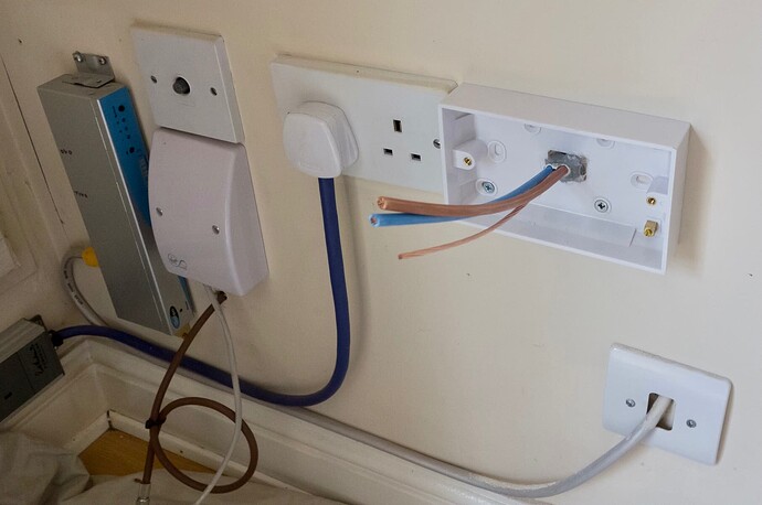

When the fat cable comes through a drill hole in the wall, how does an electrician normally install the socket?
I ask because we’re painting the room now - so I’m trying to predict how much damage the drilling and installation is likely to do (and my electrician’s on holiday so I can’t ask him).
It depends if you want it rebated or surface mounted. I had mine surface mounted as there is an HDMI cable heading up the wall for the TV where I wanted the dedicated socket to go. As the socket sits behind the racks (along with other sockets, cable feed,HDMI switcher) , I wasn’t bothered about it not being recessed.
Here’s the fat 10mm2 T&E cable coming through the wall before the wires were trimmed, dressed and the front plate fitted.
As you don’t have anything else on that wall in that area, I would imagine he would drill from the outside brickwork inwards, then wherever he comes out, install the socket there - obviously with some measurement beforehand to get to the area you want. He can then either go surface mount or flush. My 10mm SWA cable comes straight into a flush mounted double socket, using a slightly deeper box than usual to give maximum flexibility for the cable. I think the box is 35mm rather than the usual 25mm.

A lot will depend on where the socket needs to go relative to where it comes into the room. A wall chase with capping may be required, and you would almost certainly want a plasterer, not an electrician, to make good afterwards.

The alternative is to go the surface pattress route per @james_n 's pic.
FYI, my deep surface pattresses protrude ~55mm from the wall (exc the plug top). You may be able to get away with thinner (worth mentioning that sparks often like surface mounts given no need to cut out the holes and ‘make good’ – the latter not an accurate term often).
