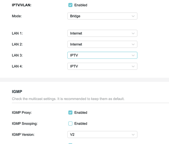

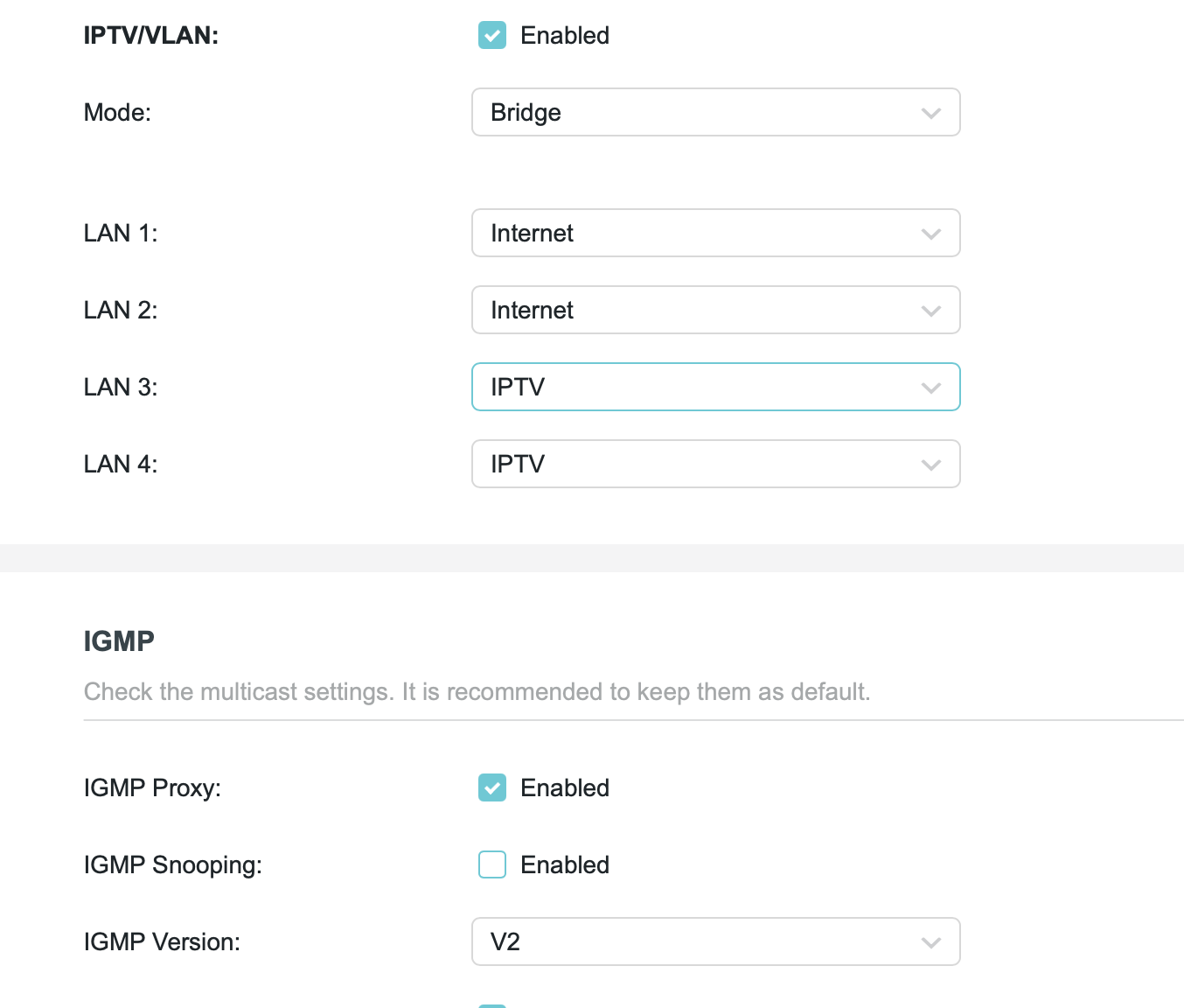

@Simon-in-Suffolk
My router does have IPTV.
Would changing any of these (default) settings help speed up the Naim App?
Which ISP provides your router. If its a BT one I know it supports a querier - but that doesn’t look like a BT screen. If it’s a third party one then without looking on the network or specific management information on the connected 2960 there is no way to confirm for sure whether it acting as an IGMP querier, but it would/should say in its instructions. Specifically you should look at its instructions anyway. An ISP provided router supporting IPTV will likely be plug and play.
There is an option for IGMP snooping - so you should enable that if you connect your streamer directly to a switch port on the router. The proxy setting is only relevant of you are consuming multicast group data from the internet - such as IPTV from your ISP.
The IGMP version I suggest leave to the latest version/highest number unless issues. Naim software supports all current IGMP versions I seem to remember.
Thanks Simon.
All my audio is connected to a Cisco 2960 fed from the router. The only devices connected directly to the router are my iMac and an Apple Time Capsule
