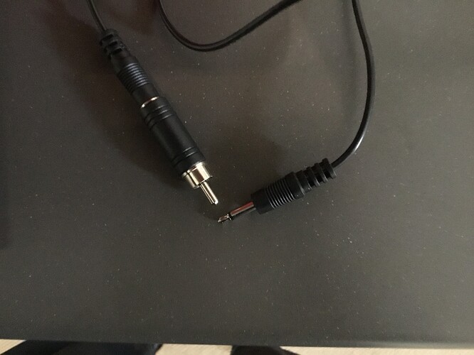

Can someone show me a photo of a suitable cable, or link to one on Amazon, please? I thought it was just a 3.5mm to 3.5mm one but I’m not sure anymore.
The 252 needs an RCA plug, the other end is 3.5 in the NDS.
So it’s an RCA - 3.5 cable.

Mine was from an online retailer called Kenable, either direct from their website or via eBay, cost about 65 pence, available in a choice of lengths to make cable dressing easier. It’s the 3.5mm jack to single RCA version which is what you need for a separate preamp.
(It’s the integrated amps that use 3.5mm jacks both ends.)

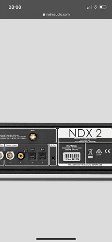

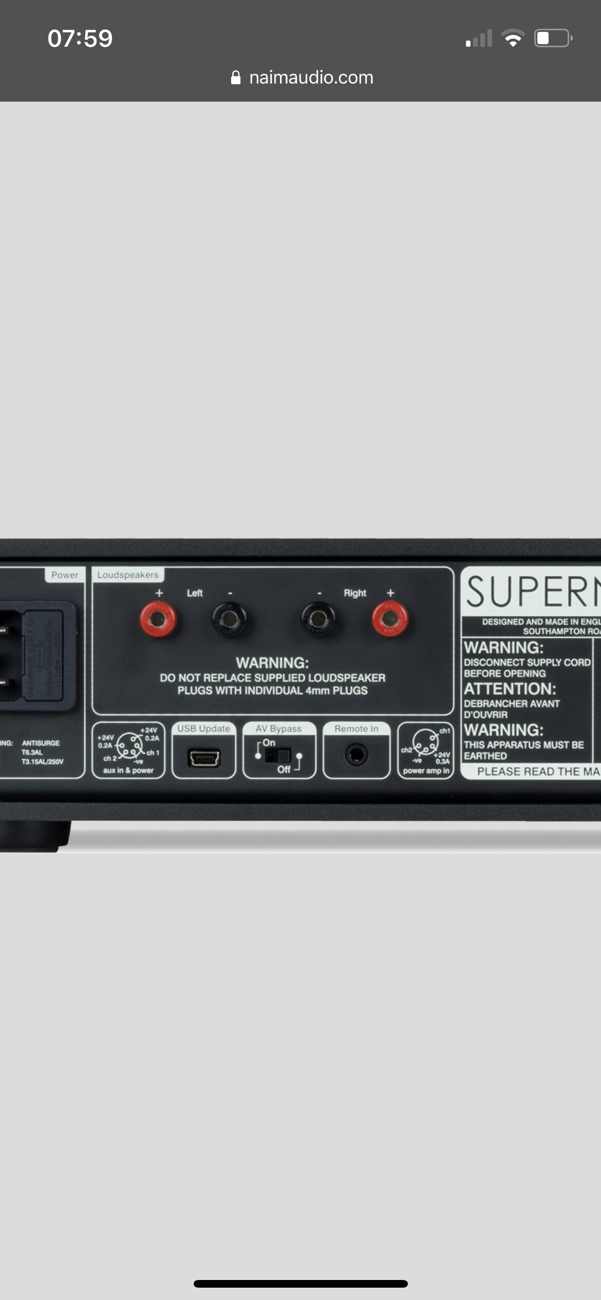

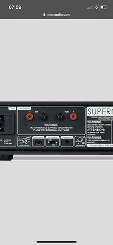

My NDX2 and SN3 have 3.5mm plugs for SA. One is called ‘IR out’ and the other ‘Remote in’. Even here on two very recent products it’s not totally consistent. If IR was written as remote it would be more helpful. It’s a tiny thing, but does everyone realised that IR means, presumably, infrared? And then the NDX2 and ND555 use zigbee…

OK that’s ridiculous really. I should have known about the NDX2 but never looked at the label. I see now that the quick start guide calls it “remote output” and adds a picture of a remote. Not helpful at all to make it inconsistent with the print on the back and not explain.
And now I also remember that someone asked a few days ago if they could plug an IR receiver into the “remote in” on a cd5xs and I understand why one would be confused.

On my Supernait the sockets are marked as RC5 In/Out
On NDX they are marked ‘Remote In’ & ‘Remote Out’ 1 & 2
It is an Infrared system but agree that marking it as IR in the context of Naim System Automation is somewhat confusing
