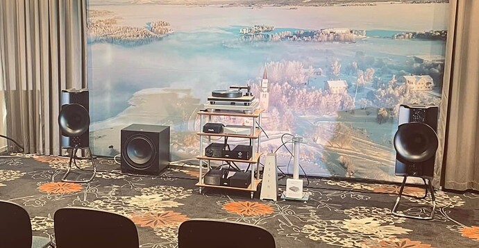

At a Swedish HIFI-show this weekend the Naim reseller demoed 222+250 with Avantgarde Acoustic Colibri (98dB) horn design. Pretty cool speakers by the way. I think there’s a misconception that some speakers need tube amps. Many have realised they get better performance out of Devore, Tannoy, Klipsch etc with good transistors compared to tube amps. The Tannoy speakers are not much different today but plays great with higher current transistor amps. What all speakers need is good electronics be it tubes or transistors.
