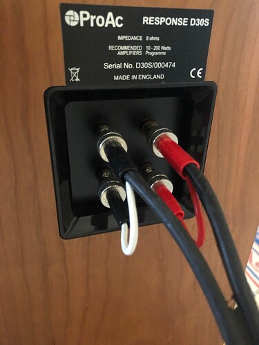

As and FYI… A photo of my NAC 5 w/jumpers soldered by my dealer and have used with my ProAc D30RS and ProAC SCM 7 speakers.
