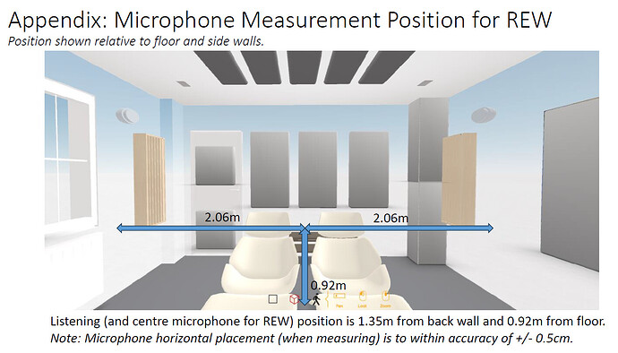

All the following graphs were obtained in my Media Room with a microphone setup as follows.
Original Image: Author provided, no reuse.

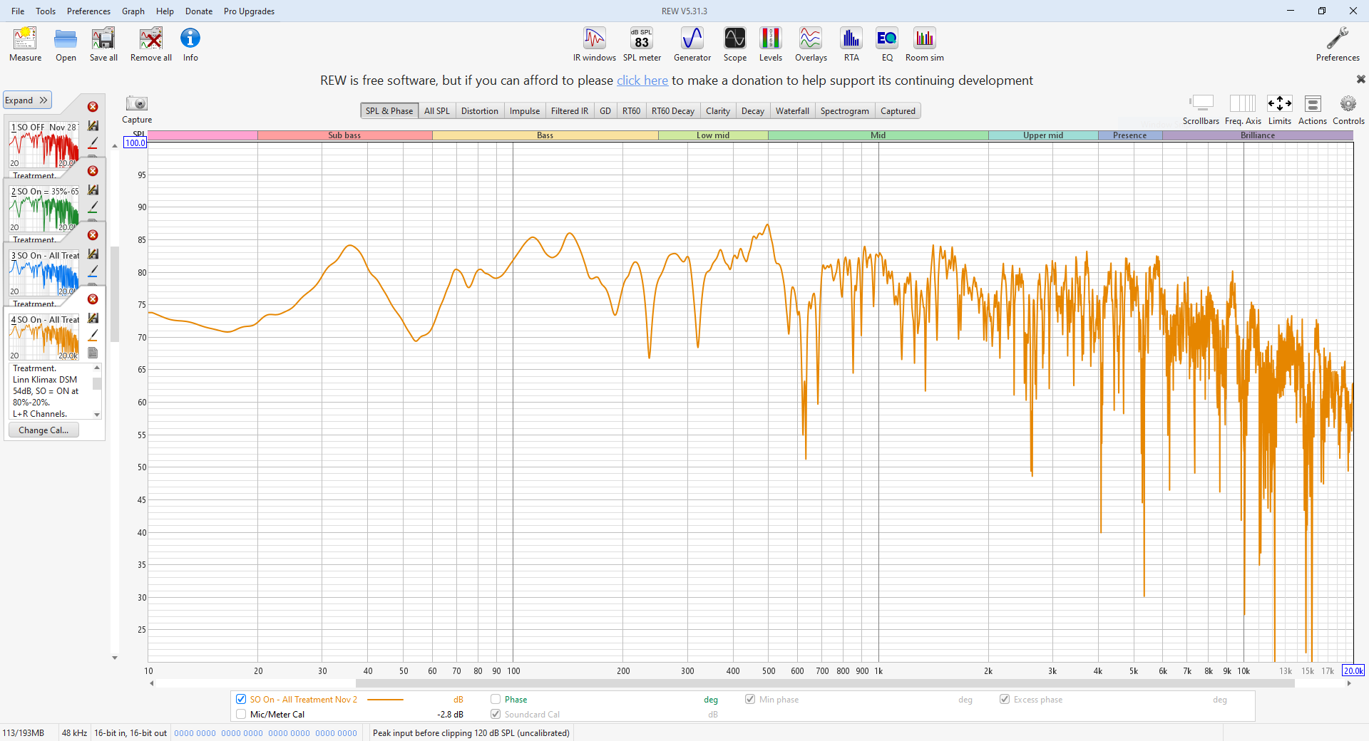

Sound Pressure Level at Listening Position (no view mode filtering)
Image Credit: REW and Author

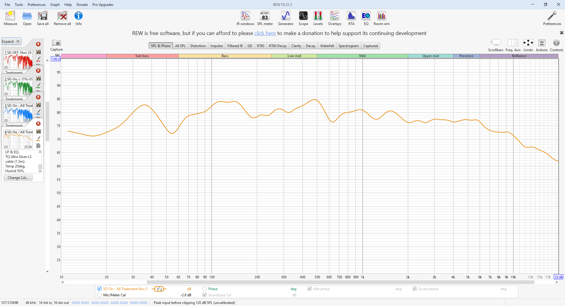

Sound Pressure Level at Listening Position (1/3 octave view mode filtering)

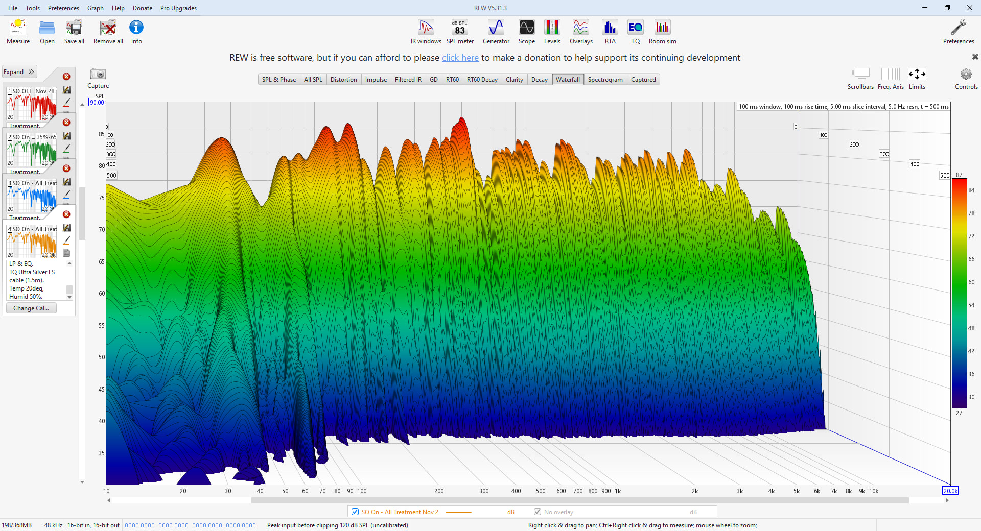

Waterfall Graph at Listening Position (1/48 octave smoothing)

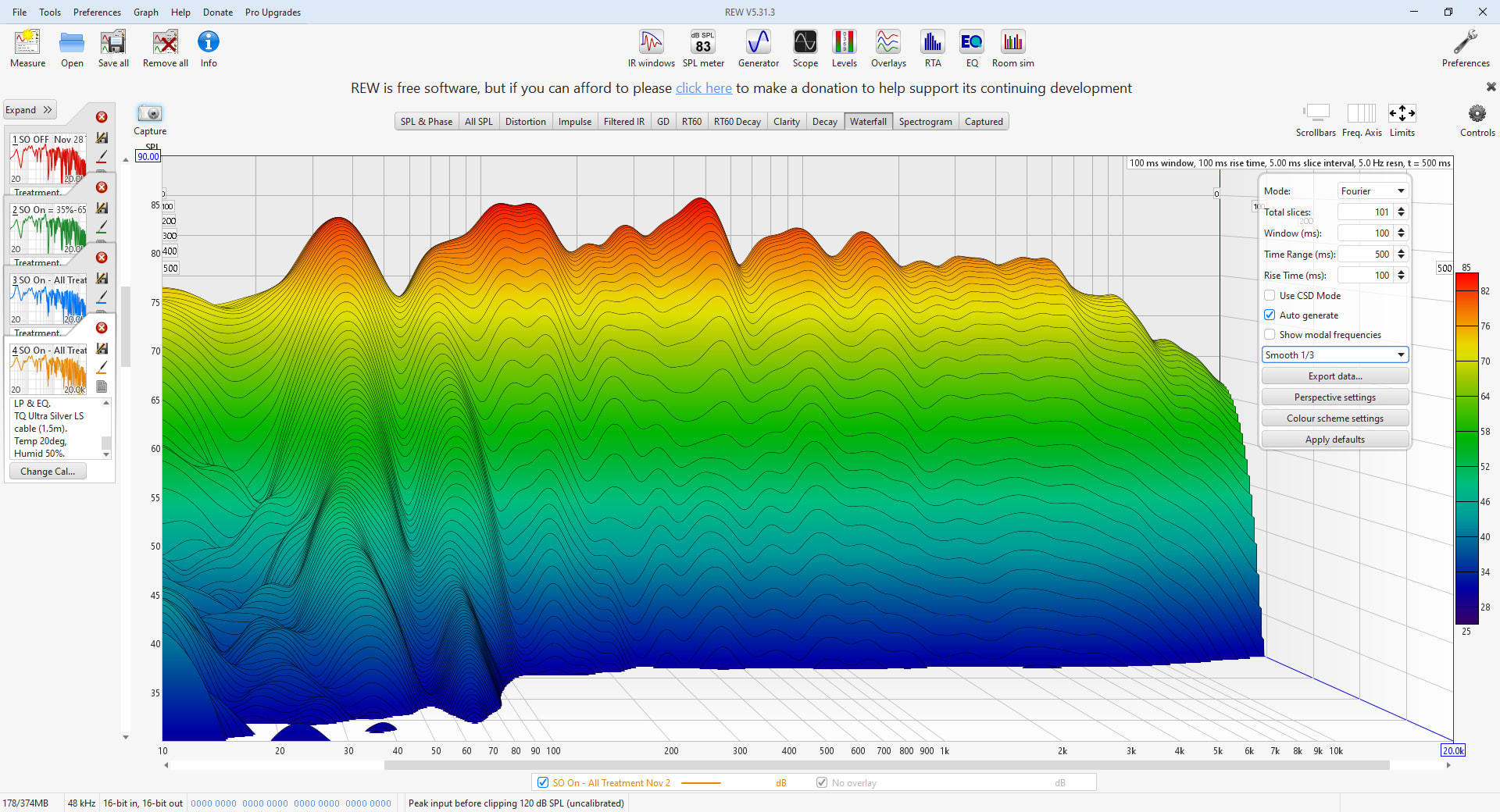

Waterfall Graph at Listening Position (1/3 octave smoothing)

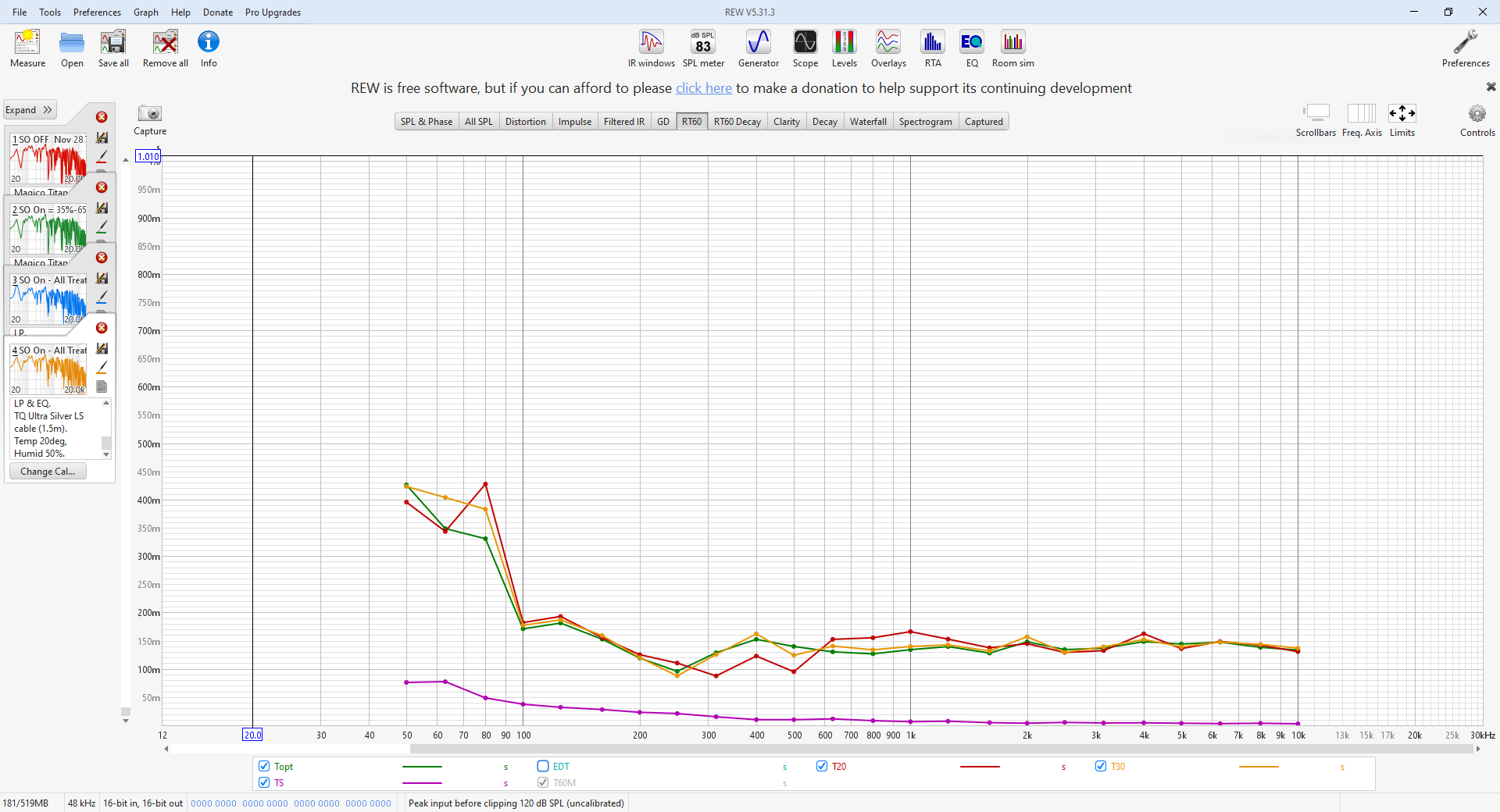

RT60 Chart…

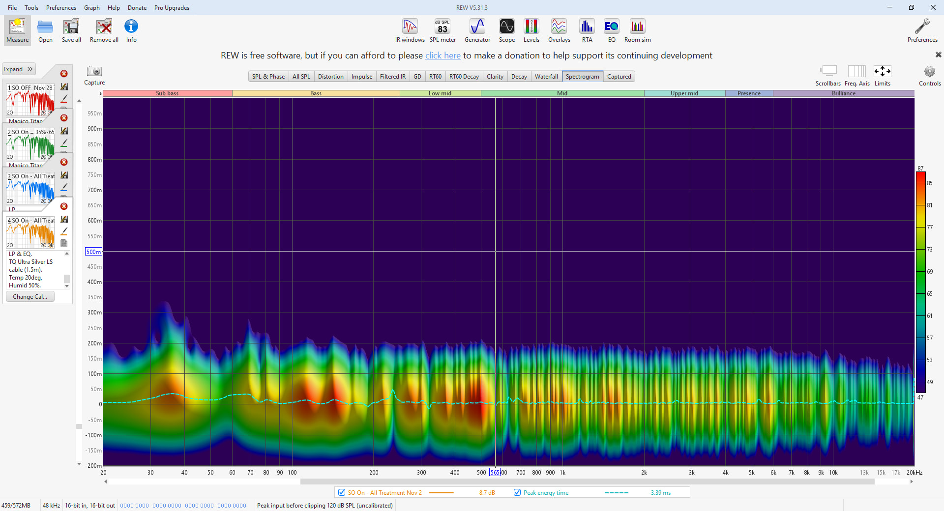

Spectrogram…
The observant will have noticed that I still have issues in the lower regions!
Which is why I am expecting to add the following GIK Acoustics products, then go back to tuning the Magico Sub Bass integration…
