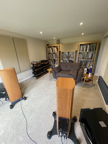

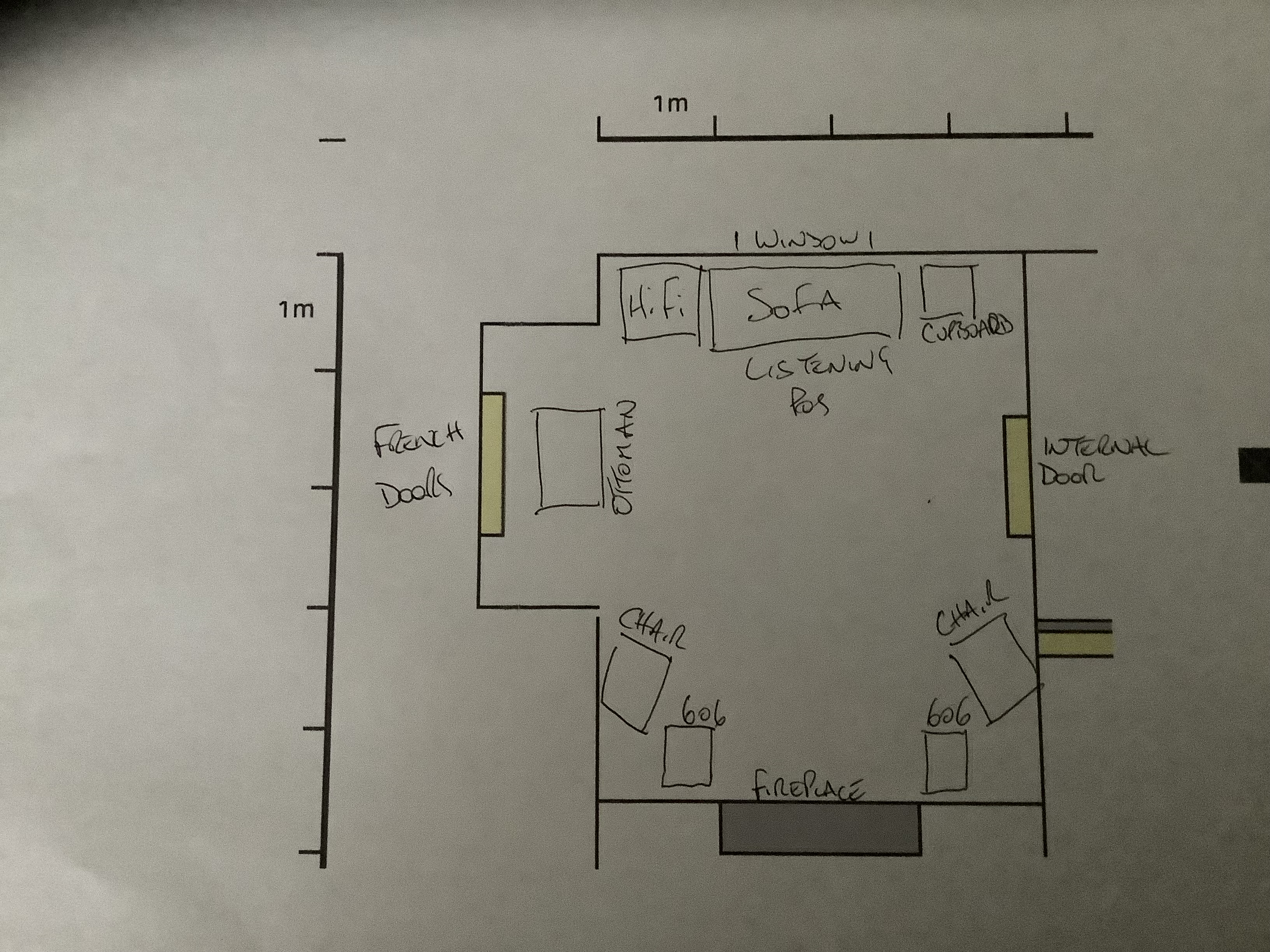

Can you provide a diagram/pic of the space and kit locations etc,?

The room….
Speakers tweeter to tweeter - 2.2M
Speakers to Listening Position - 3.2M

In which case, I think the best thing would be to plug the dimensions et al in to one of the models out there (e.g. I think GIK have one), and see what it throws out. I suspect you may benefit from some room treatment, assuming it is tenable to go down this path (?).

  1. move the sofa away from the rear wall and treat the rear wall with monster bass traps from Gik
  2. if the chairs are as close to the speakers as they look move them, maybe to 1st reflection point
  3. you mentioned suspended floor. What is below it? Mine has a 5 foot space/foundation below and acted as a giant uncontrolled sub woofer. Isolation (isoacoustics/stillpoints etc) under the speakers made a huge difference. My hunch is this is the issue if you have not isolated the speakers.
I don’t know the Kudos Titan and can’t judge whether they are actually optimised for placement close to the wall. I have GIK Aukustik Room threatment myself. The best thing to do is to send the floor plan directly to GIK. They are very helpful and will advise you free of charge. The standard solution is to treat the corners and frist reflection points in the room. I have followed this and have achieved a massive reduction in reverberation time and a massive improvement in sound quality, more than by changing individual components.
There are various approaches for the listening position and speaker placement. Usually speakers need “air” around them. In addition, the listening position should not be directly against the rear wall. Is it possible to place the sofa further into the room? The ideal starting point would be the equilateral triangle, i.e. the same distance between the speakers (tweeters) as to the listening position. Other approaches suggest that the distance of the speakers from the rear wall, as well as the listening position from the rear wall, should be 1/5 of the room length. You can vary from there. With a bass-heavy piece of music, the speakers can then be moved 10 cm forwards and backwards.
