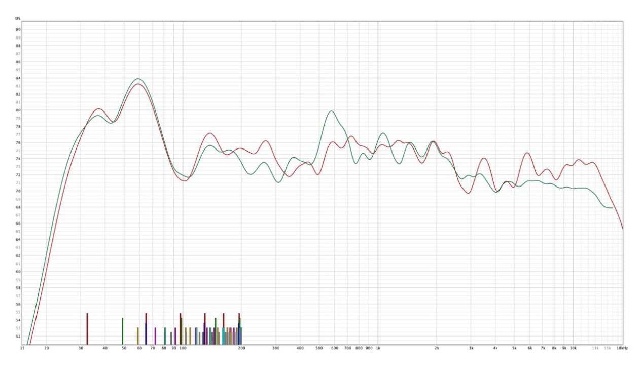

Hi @Mark63 ,
To answer your question : no, don’t buy new speakers, at least not yet.
Your measurements aren’t so bad. It could be worst, trust me.

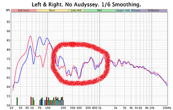

I wouldn’t worry too much about the low end as you won’t be able to really correct that. I would worry a lot more about the 250 Hz – 1 kHz range…
There are some rooms posted on System Pics 2020 that probably measure even worst, and their owners seem to be satisfied.
This tells us a lot about how our brain can manage and reconstruct all that mash (fill the gaps, attenuate, and so on…). Pretty amazing, isn’t it?
In a regular room, untreated, what reaches your ears is roughly 50%-60% reflections and only 40%-50% of the speakers’ direct sound.
Listening fatigue is a sign that you’re brain is working hard to reconstruct what you’re hearing :wink:
Treatment will change that ratio. The more treatment, the more you’ll listen to your speakers. It is that simple. And you might discover that your speakers aren’t so bad. But you may find their limitations as well.
As for your measurements, I suppose you have a calibrated microphone and use it correctly. Be aware that measuring isn’t an easy task. But there is a lot of information available.
What you want to look at when measuring is roughly the following :
A - peaks and nulls (the graph you posted)

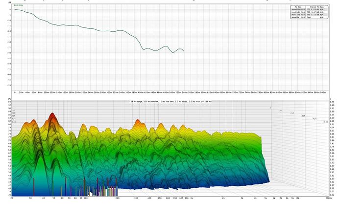

B - decay time (waterfall graph)
C - RT60
This will be your baseline for treatment.
A and B are mandatory. You want A as flat as possible and B as even as possible.
C is a matter of taste.
  • First thing first, the listening position is the very first thing you need to sort out.
  • Then speakers positioning.
  • And finally treatment.
If you’re limited in speakers positioning and listening position , then you may somewhat compensate that with the appropriate treatment.
In your context that means covering the back and front walls with something like GIK Monster Bass Traps, and the ceiling with GIK 244. Or an equivalent setup.
If your not limited with positioning then place the speakers length wise.

I used a UMIK-1 calibrated mike but only took measurements at the listening position, not at several points around it as pointed about above. Apart from that I think I’m using it correctly, it’s very easy to setup with a Mac, but will read more about it before doing the next measurements. Whilst I’ve looked at the waterfall and RT60 graphs I don’t really know how to read them … yet, more reading required!
Yes it’s amazing how our ears deal with all this, the unfiltered graph is a huge mess, especially at the higher frequencies where it’s a mash of massive peaks and troughs.

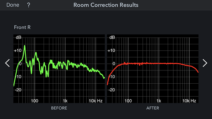

Just out of interest here is an image of what Audyssey EQ did in this room for one of my front speakers, quite a difference!
Since I will naturally be limited in how much treatment I can do in our living room I’m wondering about a combination of treatment and EQ. The latter doesn’t seem to be discussed a lot here?

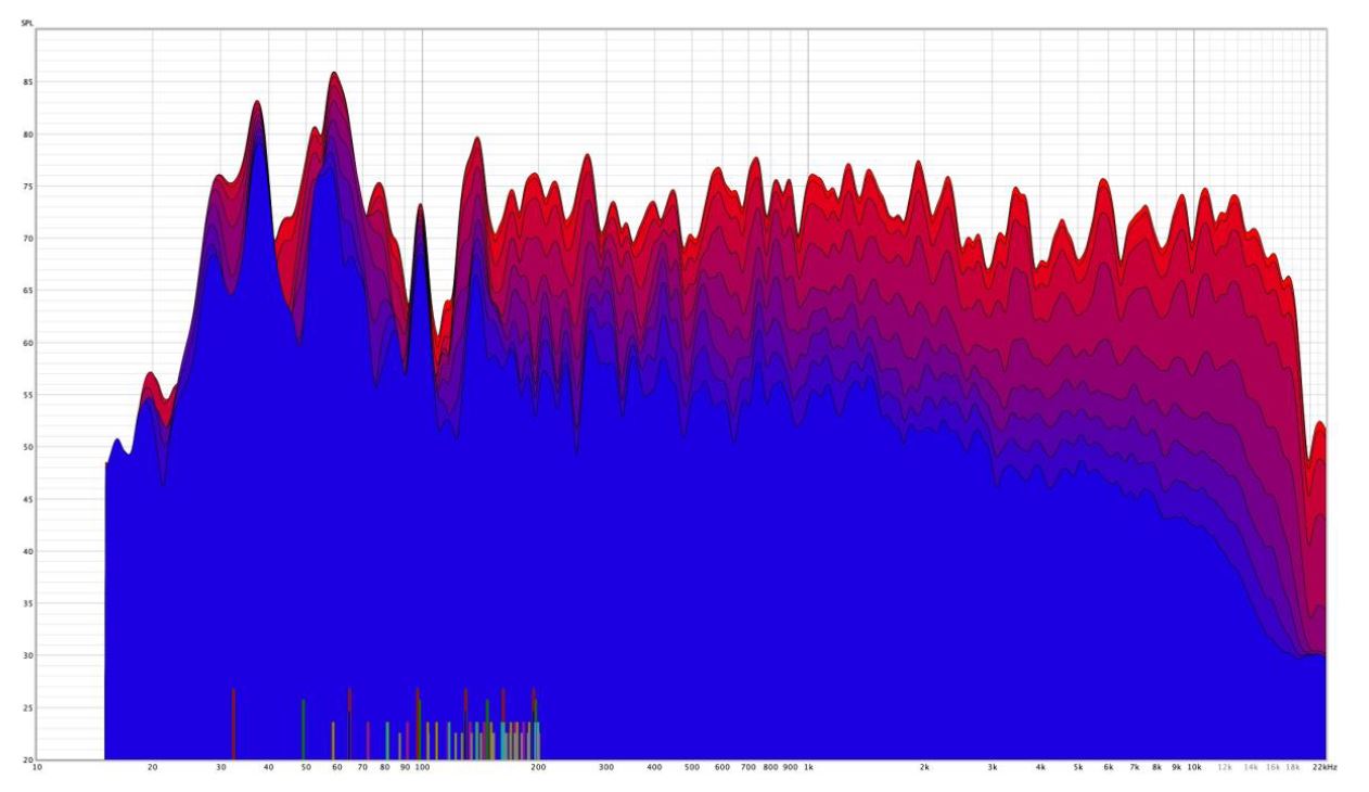

enclosed the measurements for my room. I asked an expert over to do them for me and advise if/what treatment is necessary
We will start with a number of bass traps in some corners (also in the other side of the listening room) since I the reverberation time for low frequencies is a little high. There will also be some diffusion added to the wall where the speakers are, but limited. Apparently dynamics in my room are rather ok

Big hump at 49Hz and another at 100Hz, tempering both or either would be great!

OK, those are at relatively high frequencies (in terms of true bass traps at least)…
This bodes well for tempering them using pressure mode absorbers (i.e. with membranes, not just big blocks of open cell foam). Foam ‘bass traps’ usually only work effectively down to about 120Hz, so aren’t really ‘true bass traps’ - more like partial bass traps. Large amounts of foam may be able to help with the 100Hz, at the expense of over-damping the 100Hz to 300Hz range, but that will have little effect on the 49Hz - hence the need for membrane based based bass traps.
Those problems are fixable - expensive if you go down the commercial Bass trap route, relatively cheap if you make some DIY non-resonant damped membrane acoustic absorbers yourself. Be aware you’re still talking about severl square meters area of absorption to make any real impact.
